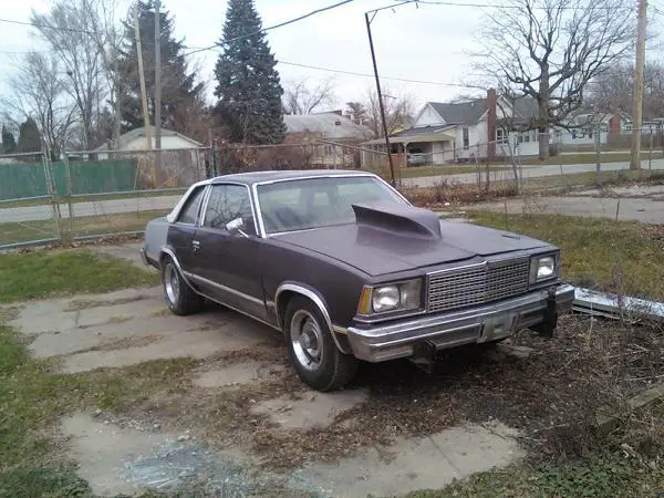

Well I finally sold my camaro to finance my malibu build. This time I'm starting from the back and working my way forward. This will be my first attempt at a car that will actually see the strip 1/8 mile. I plan on narrowing the frame rails and mini tubbing the rear. Should I order a narrower (than stock) rear or run offset rims. I'll have plenty of questions and along the way so I hope you guys are patient.
My plans are to gut the car, 9 inch rear, glide or TH350 and my current BBC
.30 over 454
.100 dome pistons
781 heads cleaned up by me
comp 4X4 xtreme 270 cam
full roller rockers
weiand stealth intake
750 holley
I know it's a truck cam but it's already complete and fresh
