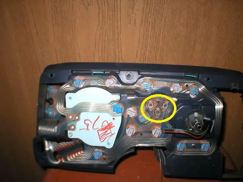

The speedometer works using a ring inside a spinning magnet, the faster it spins the higher the speedo reads. There is a wound spring that counteracts this. A lot of older speedometers are prone to this. You could try lubricating the speedometer cable or replacing it. How much does the fuel gauge fluctuate... is it while the car is sitting still? While accel/decelerating? There may be a poor connection there, but I know mine tends to fluctuate sometimes, just from the fuel moving around in the tank. Other possibilities could be the connection to the dash harness (could try cleaning the contacts), or replacing the printed circuit board, the plastic tends to separate on the older cars and the copper corrodes. If you wanted to get a DD cluster you would need a housing from a gauge-style cluster.
The cluster must either have gauges; if it doesn't have gauges it must not<i></i> have warning lights where the gauges would be, otherwise the cluster won't work.
This is an example of the back of a cluster that won't work. The housing needs to have connections for gauges in all 4 locations (circled below). You will also need to re-pin the harness at the cluster.
http://www.maliburacing.com/gauge_conversion.html
