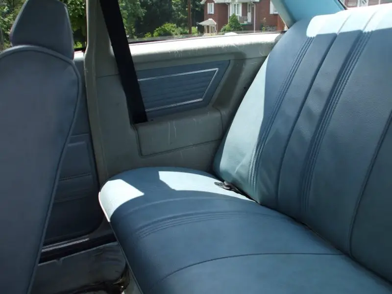

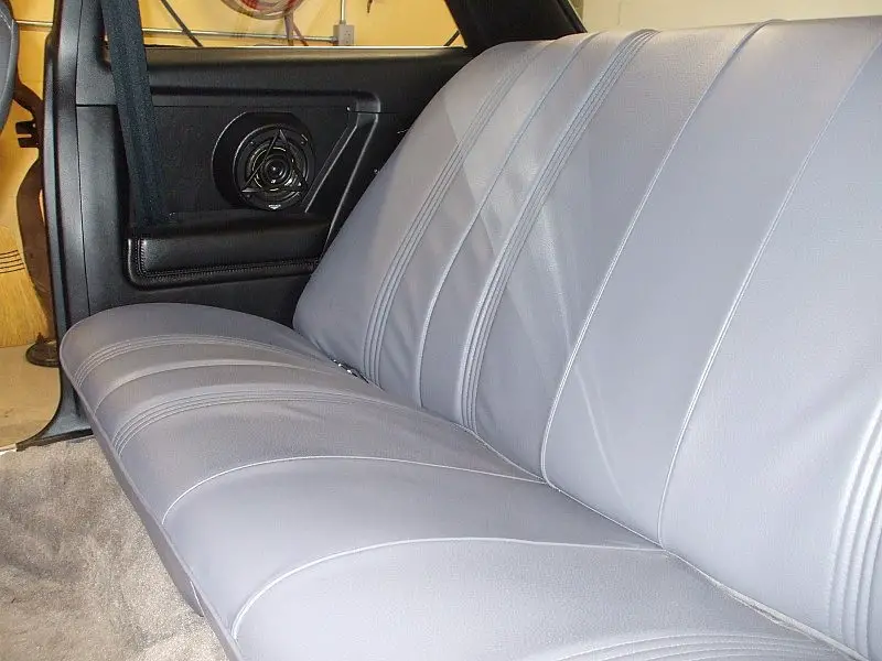

It will NOT come off on your clothes, I've used on many interior parts and it is worth it's weight in gold. Do it!!! I did my whole dash too :D

I've never sprayed seats before but i have used sem products to change the color of all my interior
panels with good luck.do yourself a favor get any/all tech sheets and follow them to the letter.if the supplier doesn't have them, sem has an excellent website.get the rite adhesion promoter if they call for one,go through the steps to decide what your surface might be etc. and like painting anything it's in the preparation.and sem has a procedure for everything and they do provide part numbers for what they want you to use.
carry on!

Have used SEM's for years(20+), and never had it rub off on anything or anyone. Make sure you have it clean, then clean it again, a mild mix of DAWN dishsoap and warm water. Use the SEM's prep on it after you clean it, then use light coats of the color coat, if not it will stripe and humidity streak bad. And the Dupli-color stuff is a joke, I have re-done more than a dozen sets of door panels that it has peeled off of in sheets.
