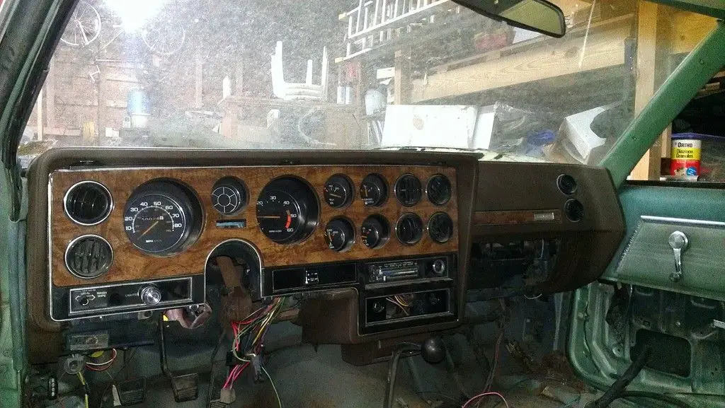

yes, they fit in there good, you have to trim 1/8 of an inch off the top of the plastic duct work top. It's like were they melt or join together the two piece to make the duct behind center vent. It's just so the speakers can slide in a 1/8 of inch to use origanal mounting tabs, once you make the cage to hold speakers.
