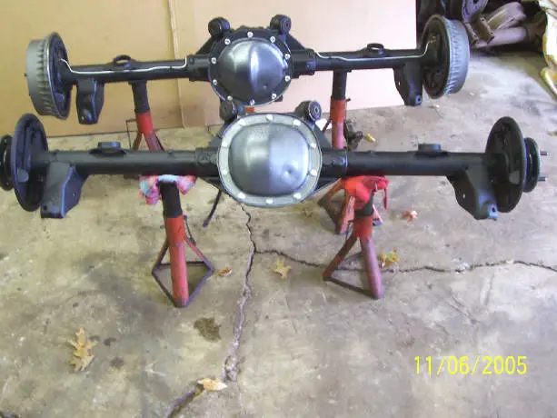

The 7.5 will have a smaller cover and the 8.5 will be the same as a 1/2 ton truck pick-up or suv.
Hope this picture says it all.
The bolt patterns are the same 5 x 4 3/4 GM the 1978 -1981 were 7/16" 20 thread count and the 1982 -1987 were larger metric studs. Everything else is the same as width spring perch mounts lower and upper mounting points. The 8.5 will have to have a shorter drive shaft by about 3/4" because the pinion is longer and larger diameter than the 7.5 rear. Both take the exact same brakes too.
