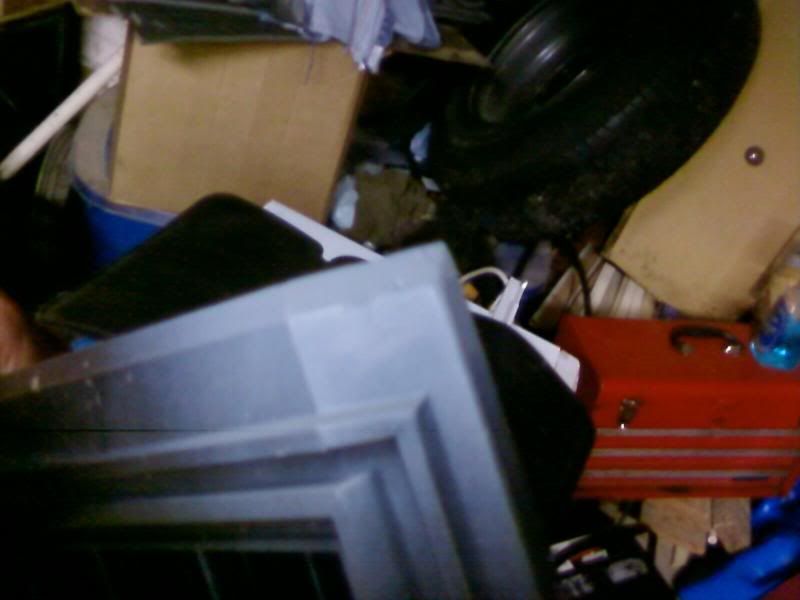

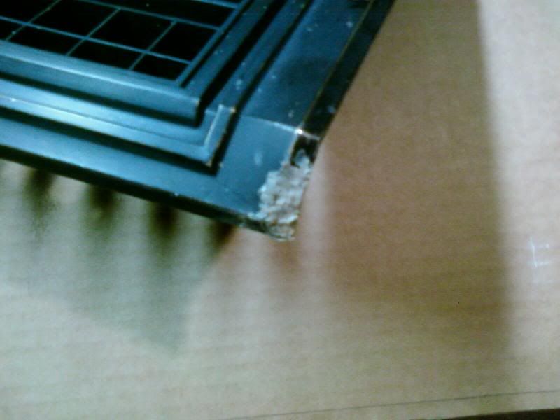

^^^ Thanks for the input. I started feeling a bit experimental today so I decided I would attempt to "weld" new plastic into the grill for the repair. I used a scrap computer drive bay blank for the patch and also cut thin strips of the same to use as "filler rod". I sacrificed a chisel style tip on my 40w soldering iron. I gotta say I'm quite impressed with myself \:D/
The bonding seems quite strong(can grasp the repair and flex the whole grill, also was not gentle while sanding) I was so excited I forgot to take a before pic #-o
right after I "welded" in the new piece and got it into the general shape it needed to be
and here is after a bit more filling, lots of sanding , more filling, ect. and then a coat of primer
Should only need a light skim coat of glaze/spot putty to finish it off
