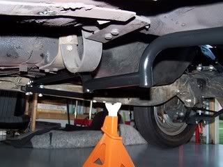

I was wondering if anyone has a picture of a iceman crossmember install? I am putting a ls1 t-56 in mine and it seems the trany hangs a bit Low. I just want to make sure the bolts to the bottom of the frame not the top.

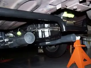

Thanks for the pic. I am having a problem with my ls1 t-56 setup on the crossmember.I put the passenger side on top and the drivers side on bottom because i have to use the frame ext. I just wanted to se how others did theirs.Justahbu said:mines bolted on top like the stock one was
80bu said:Thanks for the pic. I am having a problem with my ls1 t-56 setup on the crossmember.I put the passenger side on top and the drivers side on bottom because i have to use the frame ext. I just wanted to se how others did theirs.Justahbu said:mines bolted on top like the stock one was
Mine bolted on top on the passenger side and on the bottom on the drivers side.Toecutter said:80bu said:Thanks for the pic. I am having a problem with my ls1 t-56 setup on the crossmember.I put the passenger side on top and the drivers side on bottom because i have to use the frame ext. I just wanted to se how others did theirs.Justahbu said:mines bolted on top like the stock one was

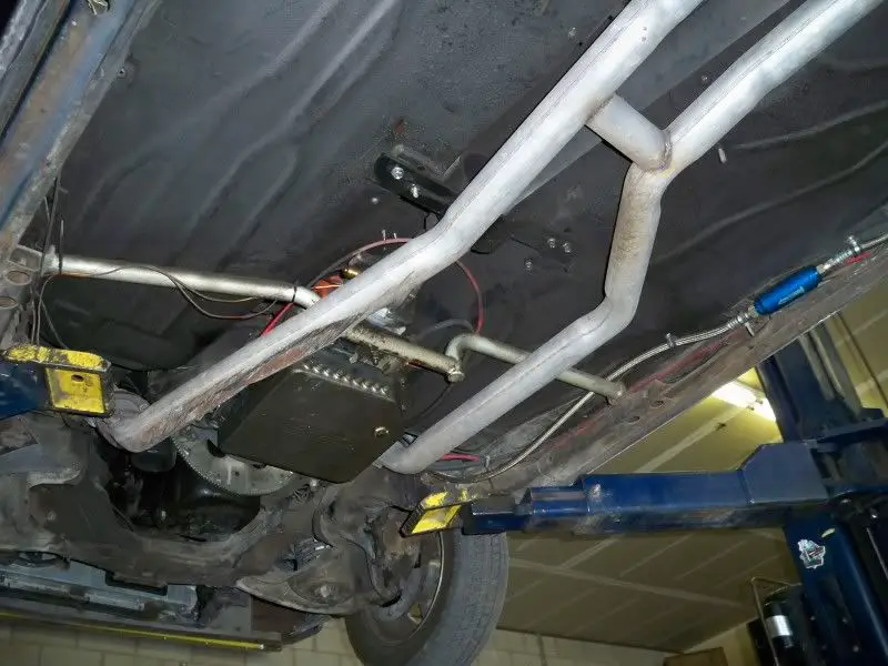

Hate to bring up an old thread, but I am having the same issue. Except I am running a TH400. I can get the crossmember on top of the frame on the passengers side, but there is not way I can set it on top with the extension on the drivers side. If I do the crossmember comes in contact with the floorboard. #-o
