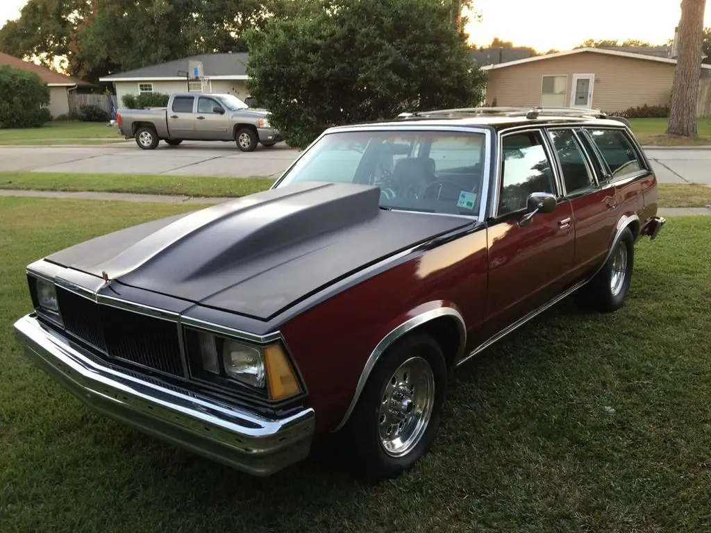

1979 project i just started. Those are 295'son the back with stock springs,...that's about as big as you can go without lift or notching i thonk.

Fronts are 17x8 with 4.5 backspace with 245/45/17's. The backs are 17x9.5 with 5 inch backspace with 275/40/17's. Rears fit well with my stock length ford 9 inch with ls1 rear disc brakes. Front fit with my s10 blazer brake setup I'm using.
