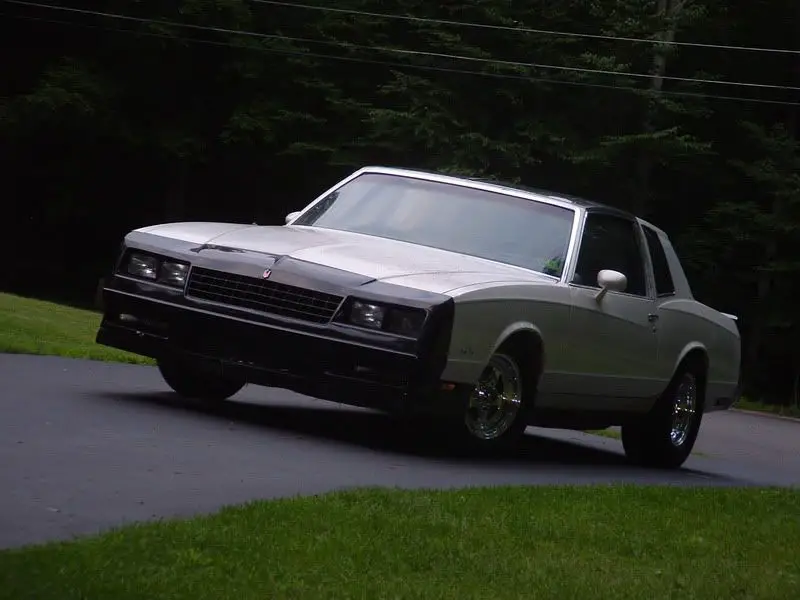

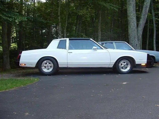

fastang, that's a nice ride. what springs in the front, what mods to get the front down so low, and does it tranfer weight ok at the strip.
faststang
Jul 15, 2007
26
Magnolia, Ky
Thanks and they are moroso trick springs with 2 coils cut and 90/10 shocks I'm acually going to change the springs this winter and add a set of drop spindals as of right now it only has about a 1/2 inch of downward travel but as far as tranferring weight yes it does a very good job. The car only runs 8.20's but leaves with the with the driverside tire up (twist bad right now) and pulls 1.70 60'
