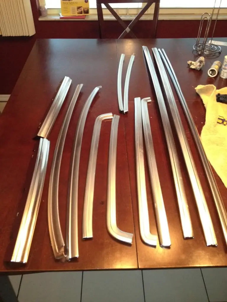

Not sure if he does polishing, but I had all my exterior trim bright dipped & re-anodized by David Russell Anodizing near Orlando, Fl. Did an excellent job. I was going to have the pieces polished, but after testing on some extra pieces decided against it due to the low quality aluminum alloy GM used on these pieces.
I would buy new visor brackets myself as there are still GM pieces available.

Do you remember how much they charged you? Just to have an idea. I guess re-anodizing might be the way to go.

around $375 which included shipping there and back, that was for the window trim, drip rails, and b-pillar trim
