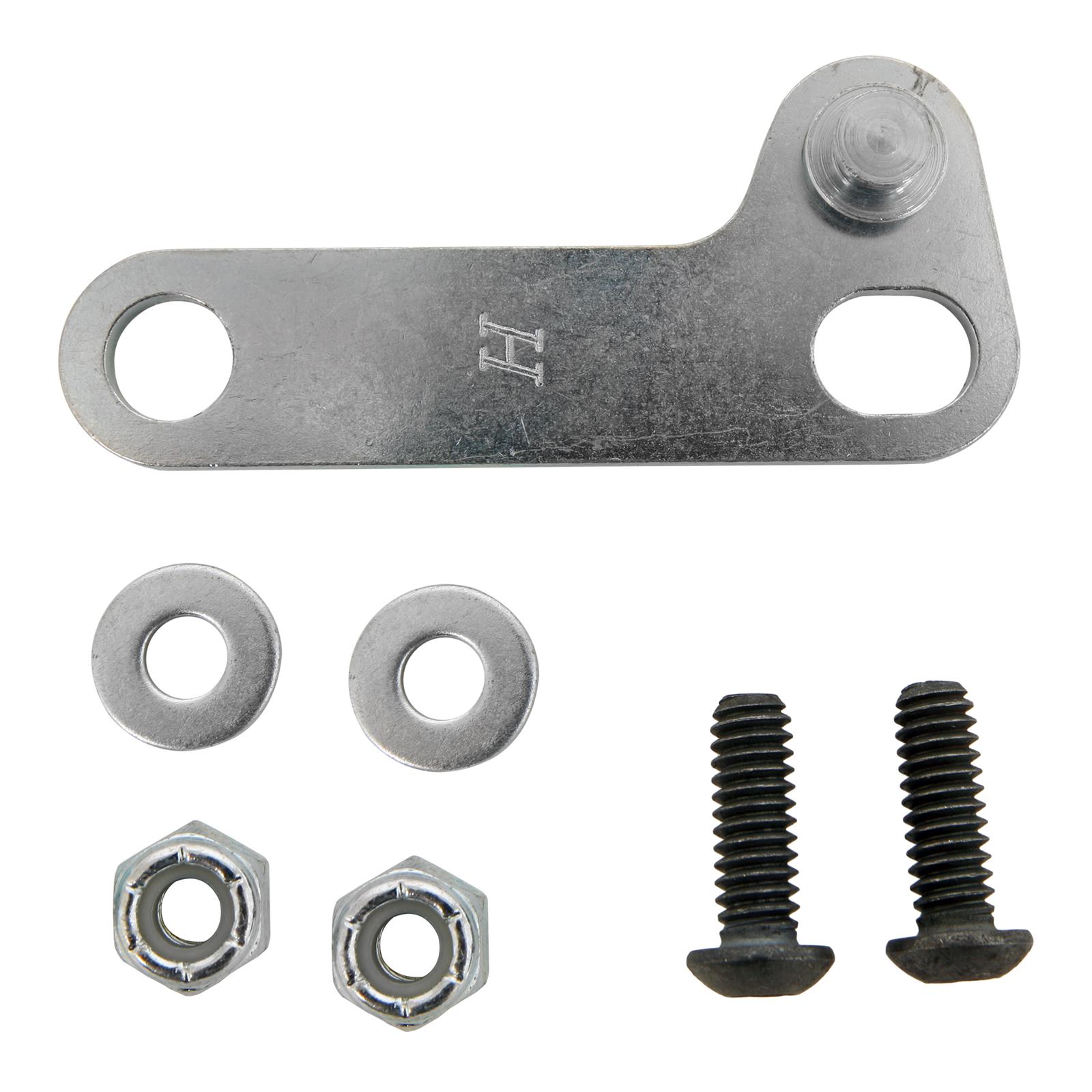

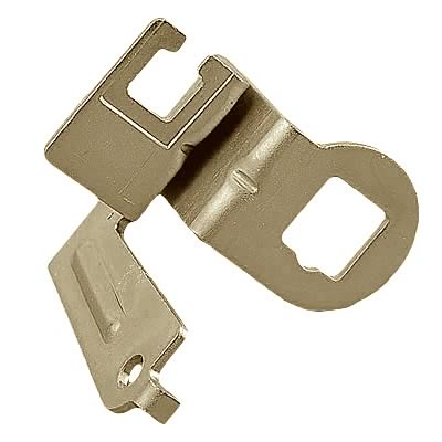

For correct TV cable Bracket & geometry corrector Bracket:

So I see the parts for the TV cable and the lock up switch are common between the 700 and 200. I prefer the idea of the converter automatically locking up when the time comes. Also, I now have the idea of going with a q-jet on a Performer RPM Q jet manifold I found for 40 bucks. Do they sell parts to do the same for this carb as well?

The TV cable Bracket Kits for a Q-Jet used with a TH250/TH350 Trans which used a "Detent Cable" are more expensive.
Some Q-Jets have the correct Linkage for a TV cable, if they were used with a TH200/200C, TH2004R or TH700R4 Trans. Some 80's Trucks used Non-Electronic Carbs with the correct Linkage. The Base from an E Carb wont work on a Non-E Carb. The Shaft can be changed tho'.
