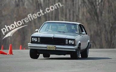

Hoping that the picture works, here's what 640 lb/in front springs, 165-ish rear springs, 32mm front and 22mm rear bars (both OE F41) do for my car in a pretty serious turn. In addition to those specs, I have replaced most of the body mounts with 88A poly, upgraded the front endlinks with (slightly modified) poly bushed endlinks, replaced the front upper and lower control arm bushings and the rear lower control arm bushings with poly. I have modified the poly control arm bushings to mostly eliminate squeaking and reduce roll bind. There's also a supplemental (large) crossmember in addition to all of the F41 braces that came as OE.
It rides a little firmly, but as far as I'm concerned, it's daily-driveable just about anywhere that's paved.

Guess I should have posted wheel/tire info. Wheels are 15 x 8.5 with (IIRC) -13 mm offset (a little over 4.25" backspace), all around. Tires have been 245/50 but were 225/60 in the picture. I did have to do a little clearancing on the lips of the UCAs outboard and behind the upper ball joints, so 15 x 8 with 4" backspacing is a safer size wheel. The fender side may need a little work either way.
