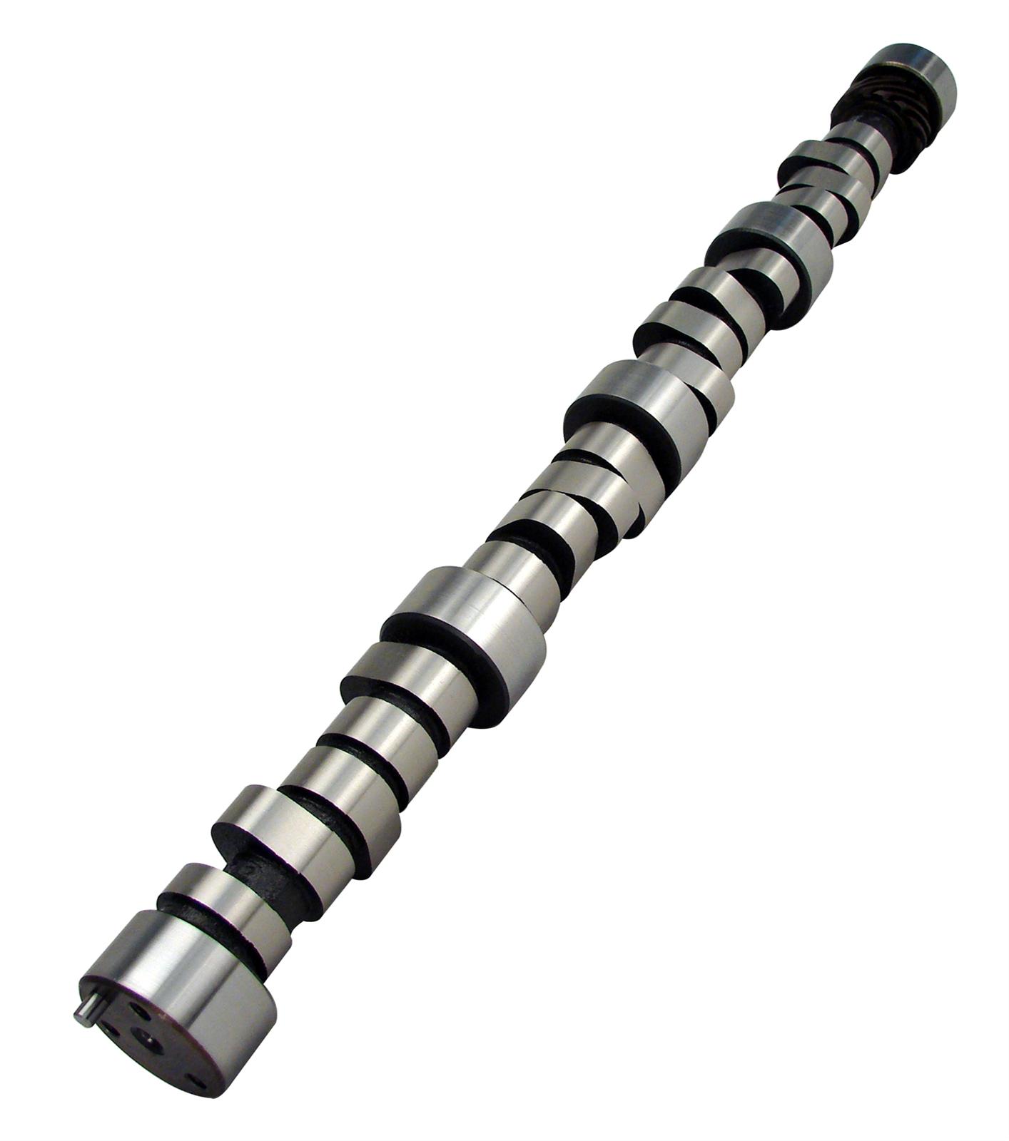

The zz series camshaft would have a step nose cam for roller blocks instead of a retrofit that does not.
Forgot about the step machined into the frt journal. At any rate, a 350 cid mtr with the zz4 series cam, ZZ4 heads, dual plane intake has sufficient power to tolerate the load of the compressor with the help of a solenoid.

The Camshaft I mentioned is just a tad bigger than the lt4 hot cam. It should be fine with an idle solenoid to help idling while the compressor is engaged.
