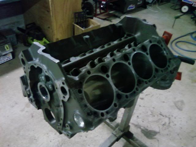

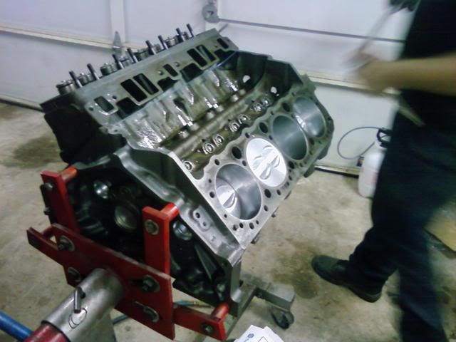

screwing together my engine for my tow rig
hey,
been awile sence i've done this, any advise is welcome
truck is a 87 1/2 ton chevy 4wd with a granny 4 speed
Combo:

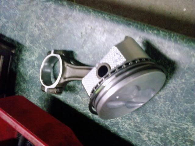

.40 flat tops
stock 87 truck heads
CAM (i was hoping to use the stock springs)
Duration Advertised 278° Intake/288° Exhaust
Duration @ .050'' 204° Intake/214° Exhaust
Lift @ Valve .420'' Intake/.442'' Exhaust
Lift @ Cam .280'' Intake/.295'' Exhaust
Lobe Separation Angle 112°
Intake Centerline 107°
Intake Timing @ .050" Open 5° ATDC
Close 29° ABDC
Exhaust Timing @ .050" Open 44° BBDC
Close 10° BTDC
Edelbrock performer intake
Holley 650 spread bore mech secondays
long tube headers
pretty much everything else is stock
i haven't built a motor in 10 years, wish me luck
Thanx
-Asa

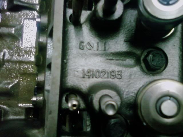

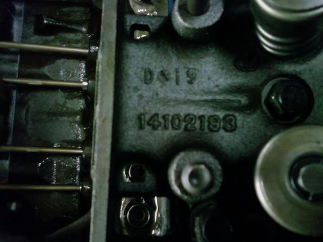

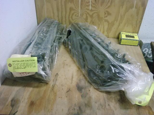

Thanx, every thing went togeter real smooth until we went to instal the rockers and noticed one head was set up for self alining and one was not :x (see pics) wich makes me ask if you can use self alining rockers on a head cast for none self alining?
you can use those rockers on both heads....your truck isn't fuel injected anymore?
