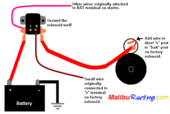

I am getting ready to install the starter. I have my truck race wired. I run the big ford solonoid, I am going to run one big wire to the starter, however, don't I have to loop something on the sttarter? Its been awhile for me. Thanx
The battery terminal on the starter needs to be jumpered to the 's' terminal on the starter. I've read some people have taken a shot piece of small diameter copper pipe, flattened it with a hammer, and drilled holes through it to make the jumper. I don't know if that would be possible in your case, but it's something I might do with mine over the winter.
