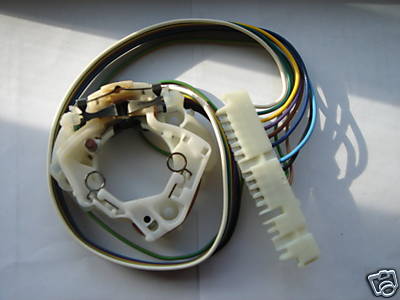

The turn signal switch is in the column.
Looks like this:
Not the easiest job so use a test ligh and be sure.

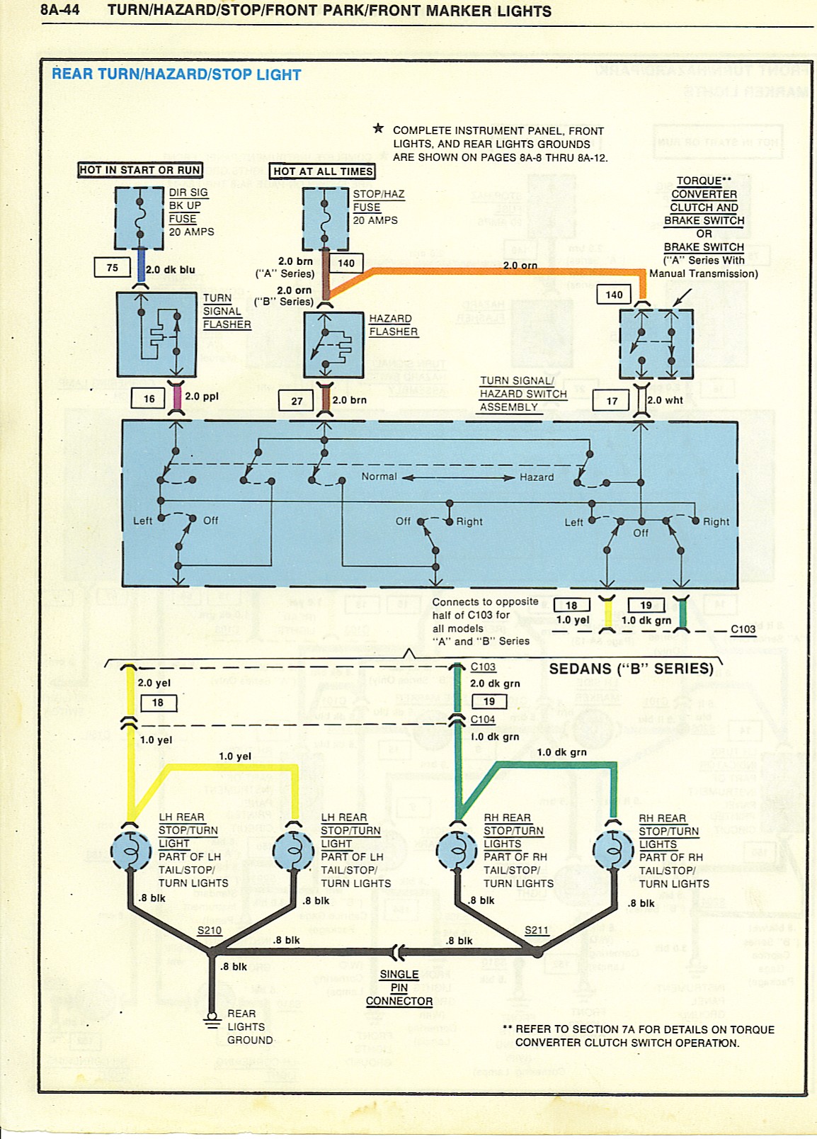

The hazard flasher and turn signal flasher are different parts, but operate the same bulbs. Since 1 flasher works and the other does not, I would look at the turn signal flasher.
