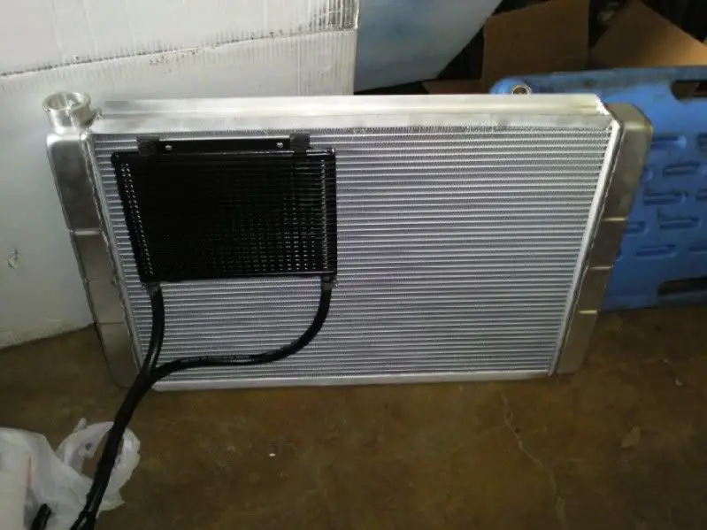

Thanks for the info and link, I will take your advice on this. How would this one do: http://www.summitracing.com/parts/BMM-70255/
I guess I will just use the hose type instead of the fitting so that way I can try and run this thing in FRONT of the radiator and A/C condenser somehow.
With the hose type do I just cut the flared end off the stock lines now and take off the threaded part and just hose clamp this puppy on? Also, any advantages of running this in front of the radiator and such instead of behind?

I would definitely run it in the front of the radiator. You want that thing to get as much of the air as possible. The radiator will have plenty of air coming through it so not to worry about that. I have mine in front of the radiator. I left my ends flared on my lines. I just pushed the lines up far enough to get a nice seal and the double clamped them. I have never had a leak from them at all. This has been over 10 years also.

Great thanks for the info. I will go ahead and leave the flared ends and the threaded part on and pushed back. I guess I will go ahead and order this thing in the next day or two. There is one that is one size bigger than the one I just posted (Part number B&M 70268). I am going to purchase that one I believe and double clamp it like you said and run it in FRONT of the radiator and condenser. dancin_banana.gif
