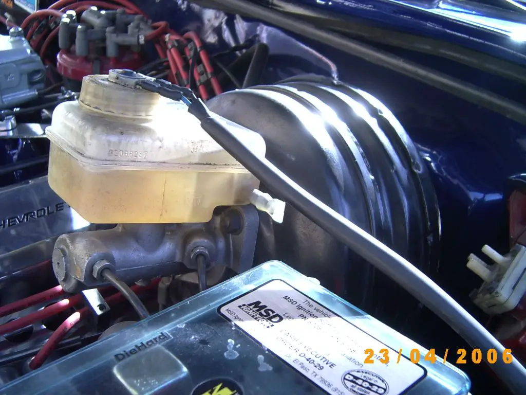

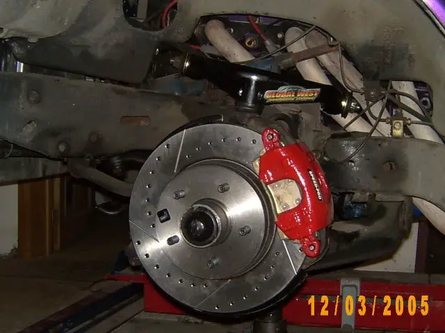

hi,
i have the same spindles on my camino with Global West upper a-arms and 1LE rotors and fits perferct ;)
and the great bore master cylinder from BMW 750i and brake-booster from BMW with double-membrane :shock:
double brake lines from front to rear, brakes X-cross

Here's the B-body/1LE swap info if someone wants to make it a "sticky".
The 1LE rotors are 12". Any year IROC Camaro or the same years of WS6 Trans AM should get you the right rotors. For upper A-arms and springs I used Global West's stuff.
Here's the parts list I used:
Spindles and calipers are from 12" brake 78-90 full size Caprice, Caddy, Delta 88, and Pontiac. Typically wagon, police or with HD towing package.
Brake calipers, (1)#18-4021, (1)#18-4020
Brake flex hoses, #BH36848
Brake caliper hose bolts, #483-205
Brake pads, # D52 ( I used Performance Friction pads)
Brake rotors, 1LE, #5994
Wheel bearings, 1LE inner, #BR6
Wheel bearings, 1LE outer, #BR3
Bearing seals, 1LE, #19753
Hub grease caps, 1LE, #13977
If you're tearing down the steering too, here's the part #s:
Tie rod, inner, 78 Malibu, #ES2034L
Tie rod, outer, 78 Malibu, #ES2033R
Centerlink, 78 Malibu, #DS909
Idler arm, 78 Malibu, #FA1013
Ball joint, lower, 78 Malibu, #FA3000
The tubular upper A-arms required should have ball joints already installed.
