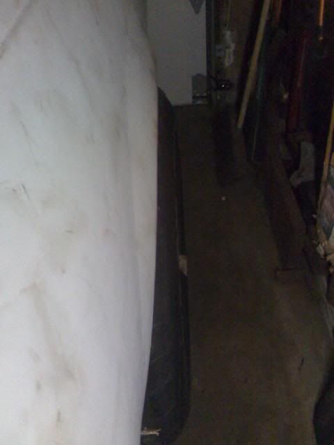

That's what I'm afraid of. When I spoke to him, he said they are tucked into the fender with no frame notch, just a cut/rolled fender. Here are the pics I got. Hard to tell from such small pics though..

maybe he told you the backspace wrong because a 5 1/2 backspace is what it takes to fit a 15x10 a 3 1/2 backspace works great for a 15x8

the malibu body is different then monte here is a shot of my 85 regal with 15x10's 3 5/8bs 32/50/15's I had a 8.5 now its a stock length 9inch they stick out half inch at best,if you do roll the fender lip you will have to lose the chrome trim around the wheel. and rolling it isn't hard at all
