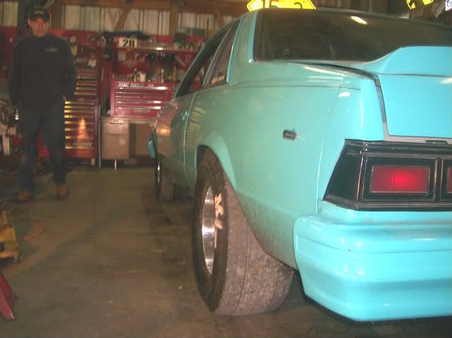

79izfine
Nov 20, 2005
2,199
massachusetts
heres a pic of my old 81 with 15 x 10 4.50 B/S all stock with a G/N rear only difference is a furtura street tire 295 50 had 1/4 spacers ,shock extensions,and the chepo $89 air bags
