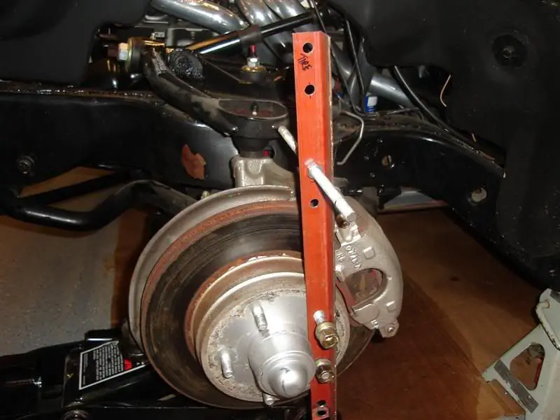

So in my effort to find new wheels I would like to go to 17's, I like the Coys that Phillip was looking at for his son's car. So I decided I would measure things up this time to figure out what fits...well this has just made it more confusing for me. I took a piece angle iron drilled holes to mount it to the rotor then drilled hole for the rim diameter and the tire diameter I was thinking of running. So I have a hole at 8.5" from the center line of the rotor to give me my 17" wheel clearance check point, and another hole 13" from the CL of the rotor for the tire.
My trouble is it appears that the tire is going to rub my sway bar at full lock, and the backspacing is not clear to me either. I was thinking I would have to run a 17X7 w/4.5" BS, but I've read here guys running 17X8's w/5" BS. Both setups clear obstructions, but it looks to me there will be tire rub either on the inside or outside of the well. Currently my 15's have about 3/16" clearance at full lock from the sway bar and the 16's with 245-50's make contact but are at full lock as well.

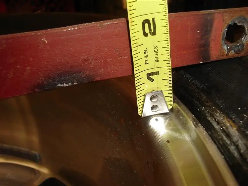

ZQ8 wheel with angle iron across the tire

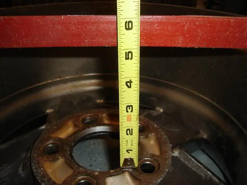

Z28 with angle iron
I tried to figure out how long a piece of all thread to use to replicate the rim but when I measure my 15's it's approx 8 5/8" wide and the 16's are approx 9 1/2" wide so I don't know how to accurately replicate that #-o Also when I tried to figure out the BS of the rims it appears they both have around 4" of BS.
Z28 with angle iron
