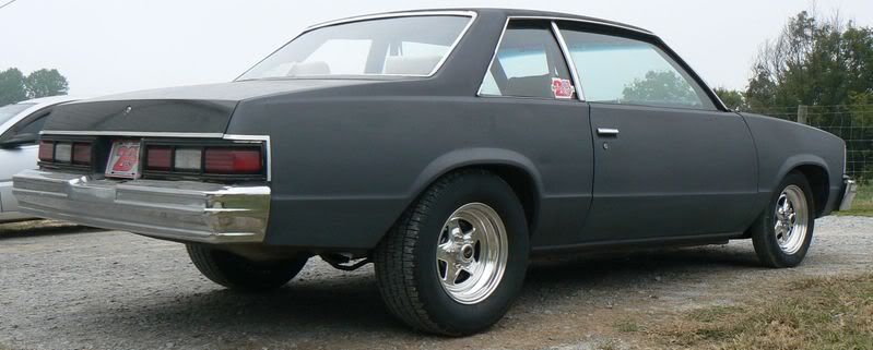

I have a set of 1st Version Weld Aluma-Stars (Pro Star) and with a 15x8 w/ 4.5"bs and a 275-60-15 BFG Radial TA (street tire) and they WILL RUB on a stock susp. / stock ride height car. I had to use a 3/16 wheel spacer and its now perfect.. This was taken with my cell phone at work today, will get some better shots tomorrow..

that looks great .my car was set up with 15 x 10 4.25 b/s it had spacers , something around 2 " mr gask shock extensions ,and the $80 air bags with 295-50-15 i just installed summit star wheels 15 x 8 4.50 b/s had to keep my spacers but i removed the shock extensions and i have 275 - 60 - 15 i am thinking my suspension will be looser [more body roll ] my springs are stock just wondered how your set up performed gotts say i liked the look of the 15 x 10 just have to adjust to the new look thanks
