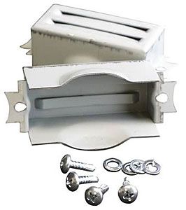

forgot to mention that I swapped out valve covers which have different baffles. I put on a set of billet specialties tall covers with baffles. They have the chimney style baffles with angled slots in the bottom. Has anyone had problems with these?
The old covers had something like this:
