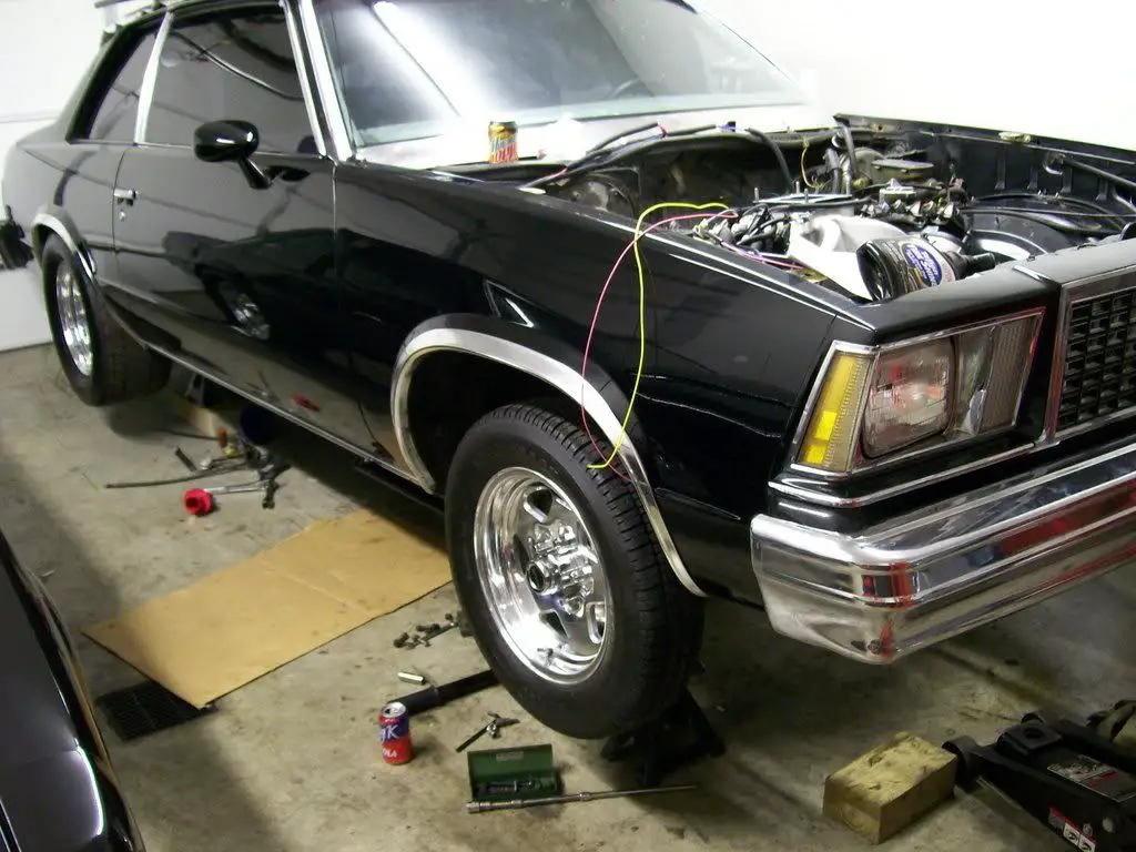

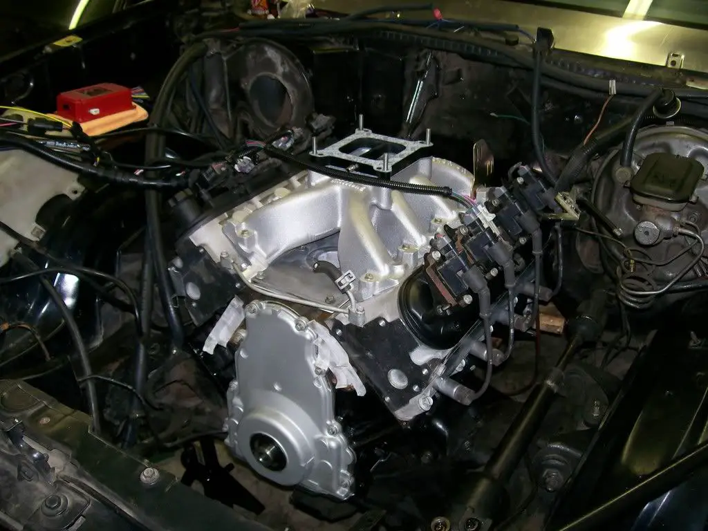

6.0 motor and transmission are in!!! - NOW A STICKY
Roller406Bu
Sep 10, 2003
396
Elizabethtown Ky

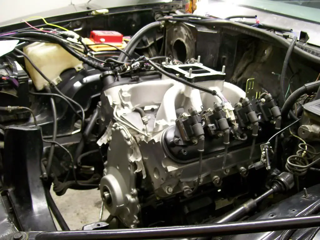

Heads are shaved .020
Magic stick 4 cam from texas speed..
Need few odds and ends to complete, if only money grew on trees.. :cry:
moroso pan is 20140 you will need the pickup they make as well to go with it...

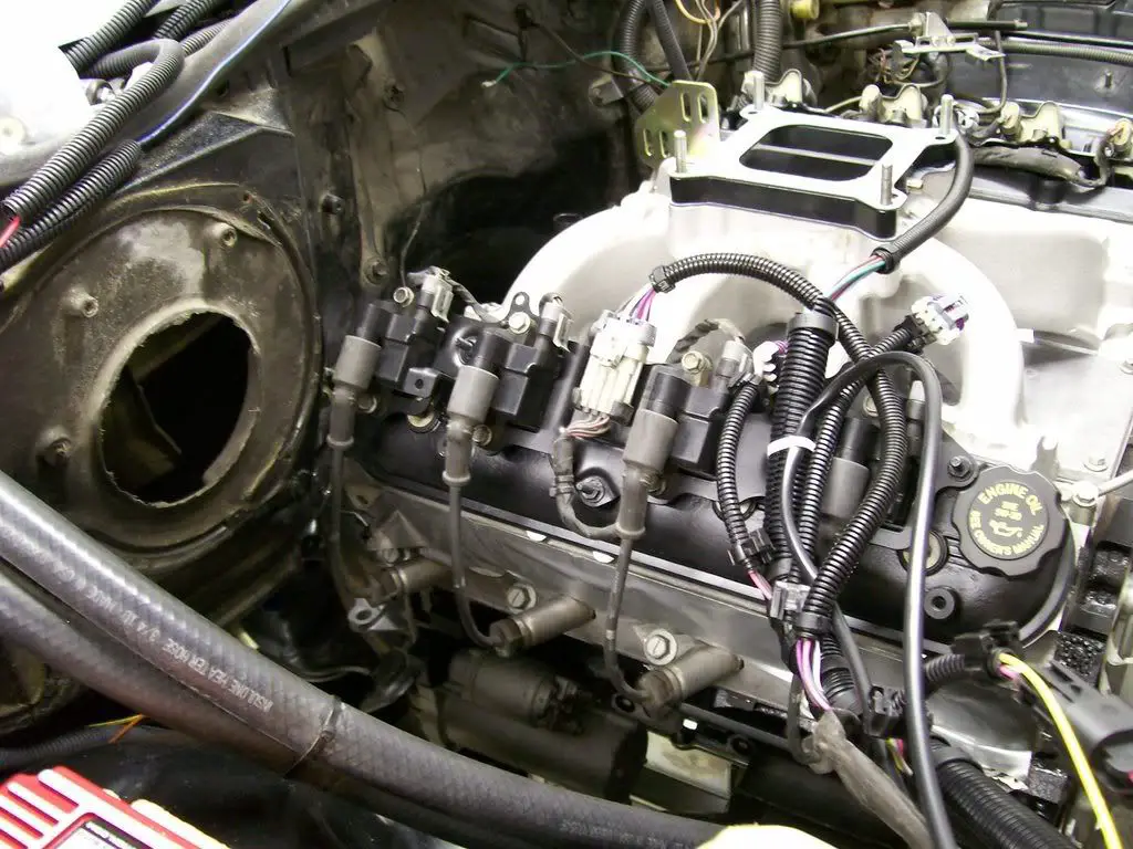

bolt on coil packs went thru my heater box, trimmed it down, fine now...

What adapter plates are you using? I'm assuming the clamshells are just stock g body V8 pieces?
Basically the setup I wanna do lol.
What are you doing for headers?
There from a company called trans-dapt in jegs, clamshells are stock yes..I'm waiting on my shoenfield headers to arrive I'll let you know...

Wanted everyone to know that this oil pan works with no mods, no one knew nowyou know!! You need these plates to make it work though, I had a another syle of plate and it hit the crossmember so use the trans-dapt with this combo....
