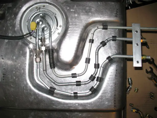

Looking for a little help on going from Carb to EFI on my '79 Malibu. I currently have a Carb'd GEN III Heads/Cam 6.0L setup, and i'm getting ready to go over to EFI and Turbocharged.
My question, can I just bolt in a Grand National fuel tank into my '79 Malibu? If so, this would be the simplest solution for me at this point. I know the Gbodies went EFI and there are other solutions. I have reviewed the Father/Son project page, and that route is viable as well, although they do not denote the line size of the hanger assembly (5/16 or 3/8th's). I prefer the Grand National setup as I am finding it's 3/8" line, and with my HP goal this is my preference.

I used a Grand National tank when I went fuel injection. Also used a GN sender but modified it. Racetronix also makes a sending unit to fit GN tanks. I ran 3/8 from sender to 6 an for supply and return. I will warn you that my tank has the fueling issue that has been discussed here. Has to do with baffle in tank I think. I have to add fuel very slowly because I didn't do the modification that others have done. Also I bought a Walbro pump from Gbody parts. Setup has worked without issue (except fueling) for 3 years now.

Also the stock sender is 3/8 supply and 3/8 return necked down to 5/16 for the hose to fit. That's one reason I modified mine. There is a special in tank hose that must be used to hook up pump. Most auto parts stores have it. Made by gates I think.

I have read some information about the aftermarket tanks, such as Spectre (O'Reilly's, Autozone, ect) having issues with the internal baffling not being the same as the Original Equipment Grand National tank, causing driveability issues on low fuel levels, is there any merit to this?
Right now, the Spectre tank with Racetronix dual pump setup is the route i'm looking at, with the mentioned vent mod for the fueling issues.

I have the spectra tank. I've never had any driveability issues, but I usually stay above 1/4 tank. The only issue that I know of is the baffle that causes fuel to splash out when filling if you don't do the modification.

Awesome! Thank you so much for the help. Looks like i'll be ordering the Spectre tank and Racetronix sending unit/pump assembly.

Glad to help. Hope it all works out. I would have used the Racetronix sender had I known about before I did my install. Same with the mod to fix the baffle problem. Something else that I was advised to do was run 10 guage wire back to the pump. Looks like Racetronix offers harnesses too. Good luck with the swap to FI. Are you using factory or aftermarket computer/system?

Tank and pumps work great! Thanks for the help guys! Ended up doing the Racetronix Dual 255 setup and the Grand National tank.
