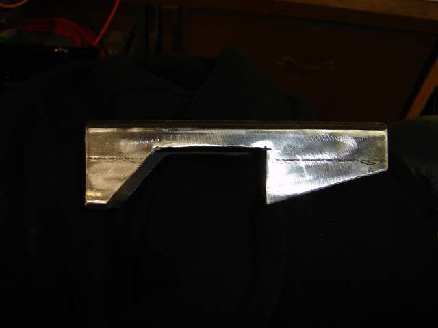

I did this BEFORE i started ripping mine off but the fix could work for you.

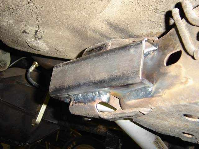

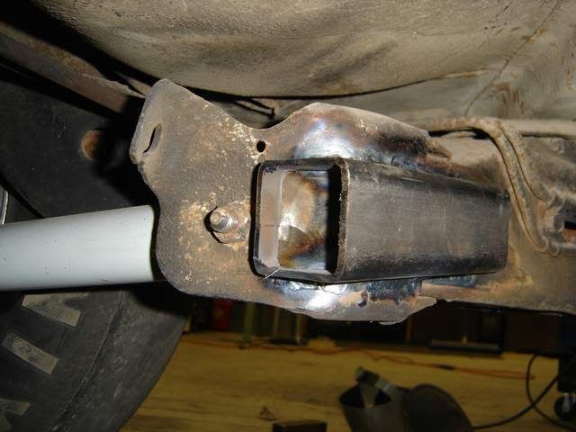

Mine wasn't ripping from the frame, but here is how i braced it
red barn
Mar 5, 2007
628
Syracuse, NY
The edelbrock tube just braces the LCA mount from pushing out and ties into the upper mount.

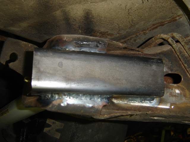

The other tube.......
well.....
it is a low buck anti-roll consisting of a ladder bar crossmember welded through the lower control arms. real low tech and I am sure it sees a tremendous amount of force. It was meant to be temporary but it is still in the car
