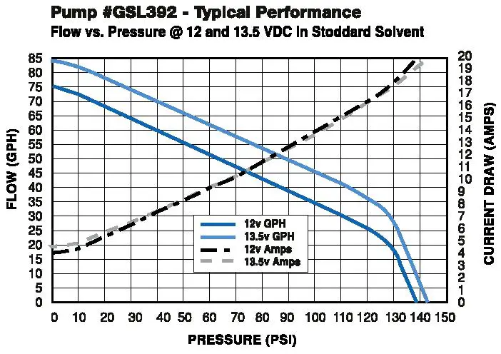

Is this a good in-line pump for a "stock" application? Noisy?
I've about given up on finding the in-tank sending unit/pump assembly at a reasonable price...... :roll:
Chart for the pump:
455_82malibu
May 19, 2006
1,400
WISCONSIN
overkill...if there is such a thing. That pump is good to 600 hp. Im using this for now, holds the factory psi fine. Couldnt beat the price.
