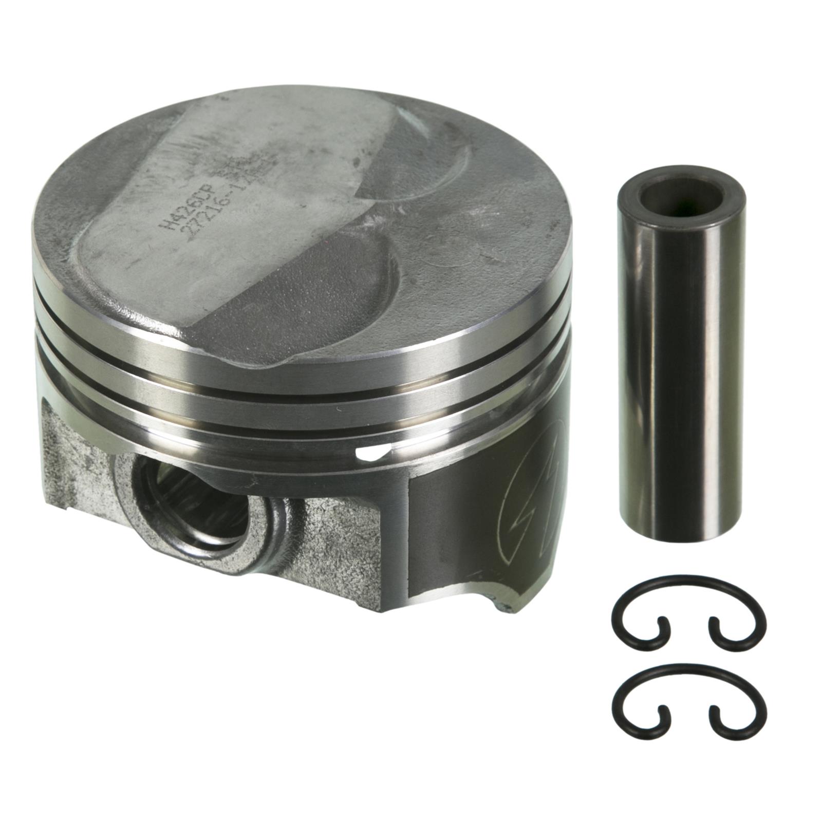

340 dome? Guessing it's a -20cc dome would put you 10:1. Mine are -11cc domes and I'm 9:1
These would put you right at 9:1

30cc dome. That's 11:1 or better.. With a 118cc chamber
Could convert to E85.. Or re piston with a 10-11cc dome

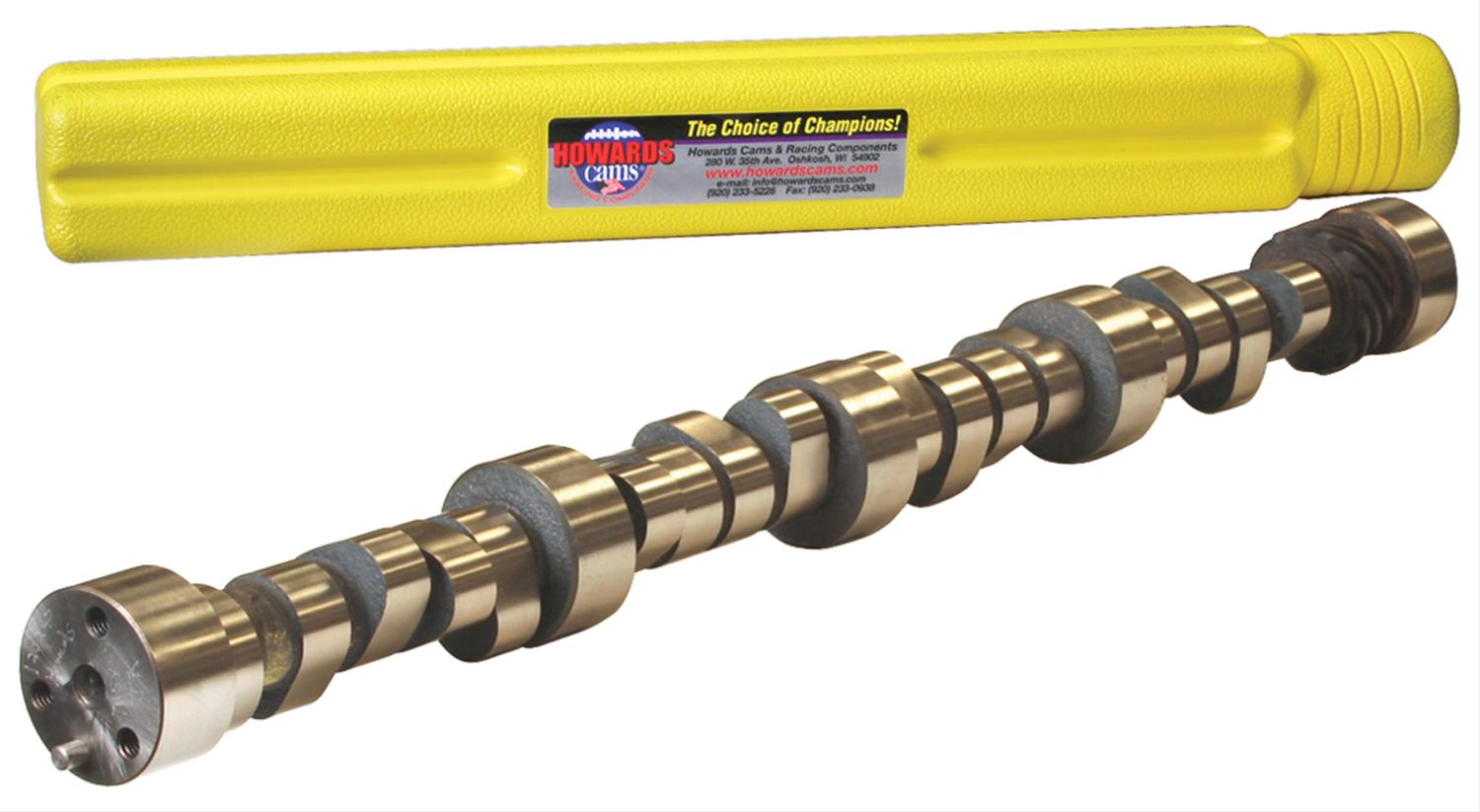

This is the HR retrocam I'm looking/thinking about

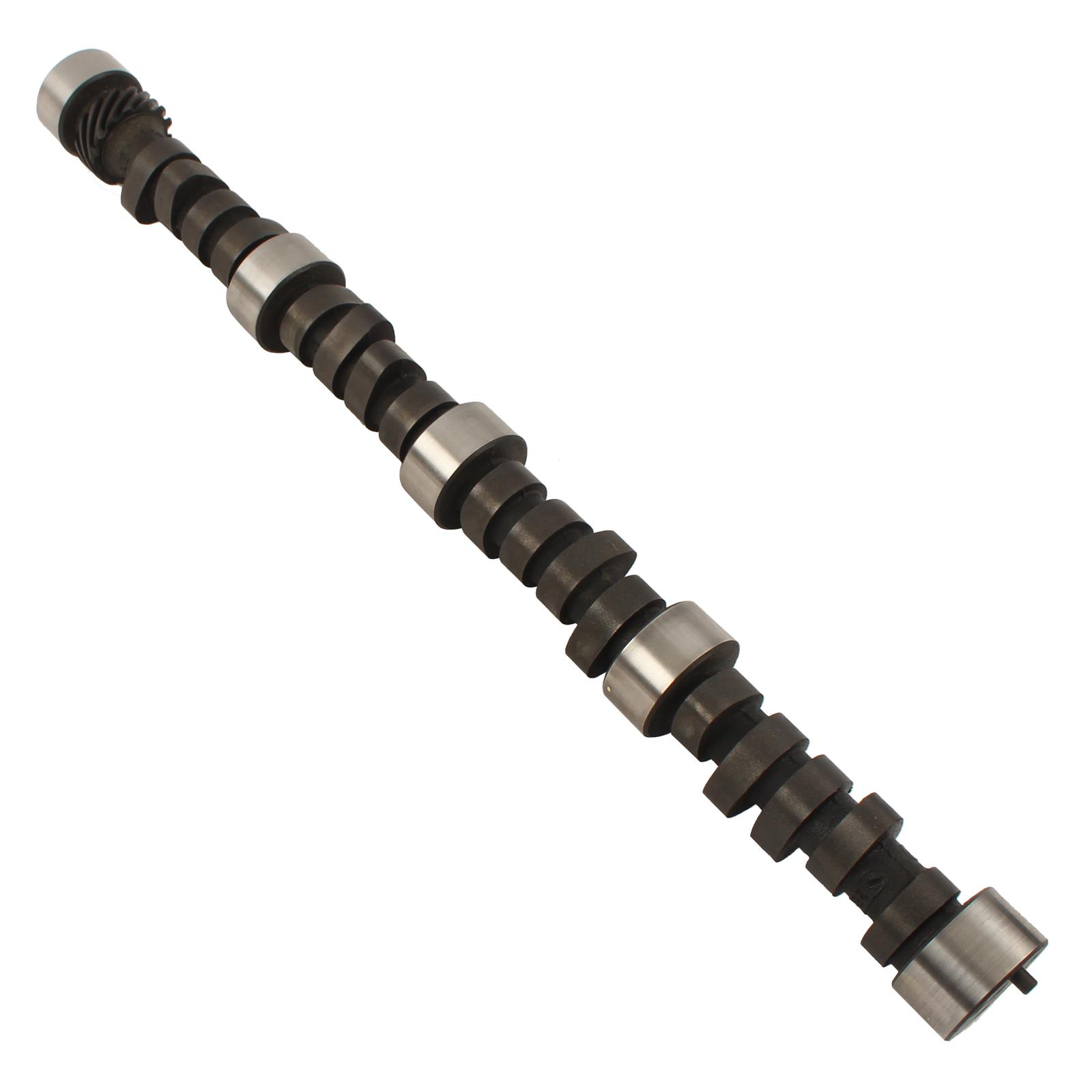

What I have right now

I've thought about the one but keep going back and forth between roller or not. Could do roller gen vi Camshaft swap is supposed to be a good deal.

According to Howard.. Theirs are drop in.. Install just like a flat tappet.
IDK what would be needed to retro a gen 5/6 cam into a 4 block.. You're looking at ~$1000.00 for retro HR cam, lifters and push rods.

Yes that is my current cam. Sounds great usually someone telling me they like the sound. It's not bad getting out of its own way. I think I could get more power with the right cam with sound not the focal point. Still need to get some tracks time or dyno and see where I'm at now to get an idea where to start.
