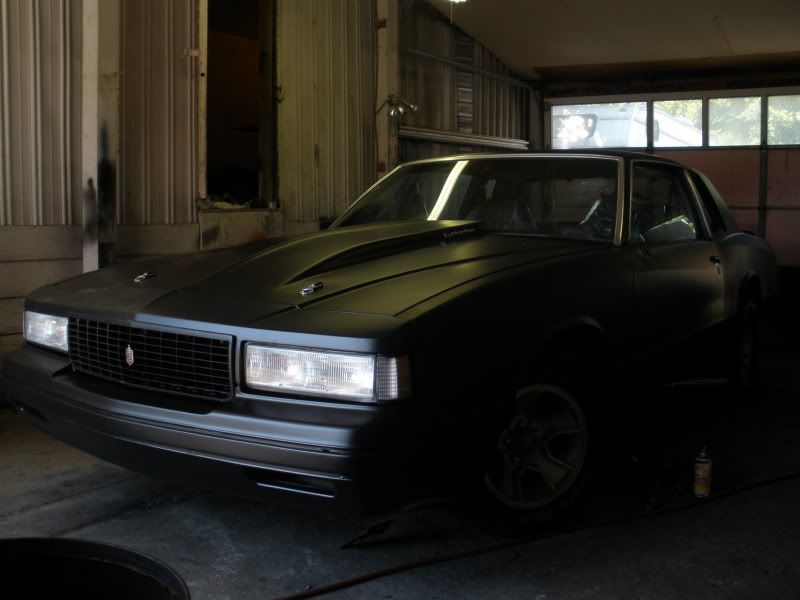

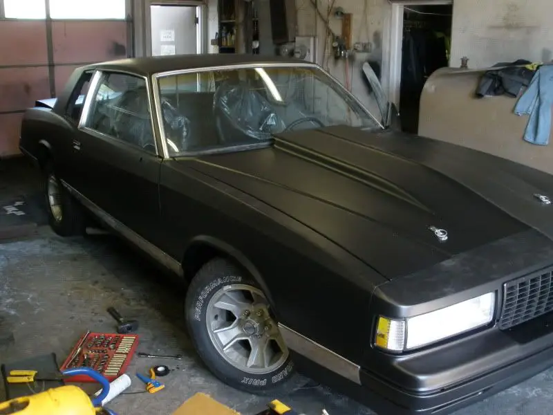

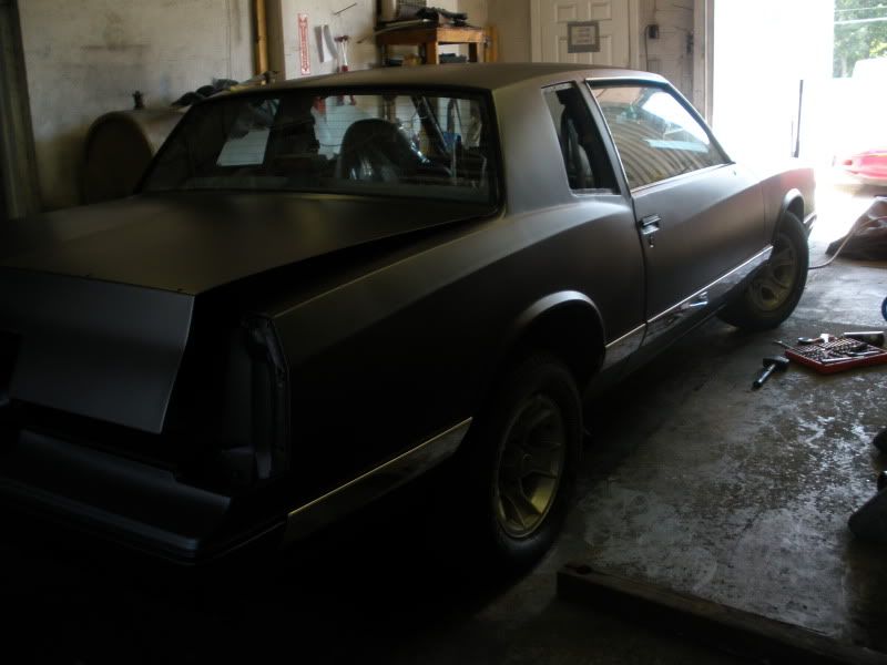

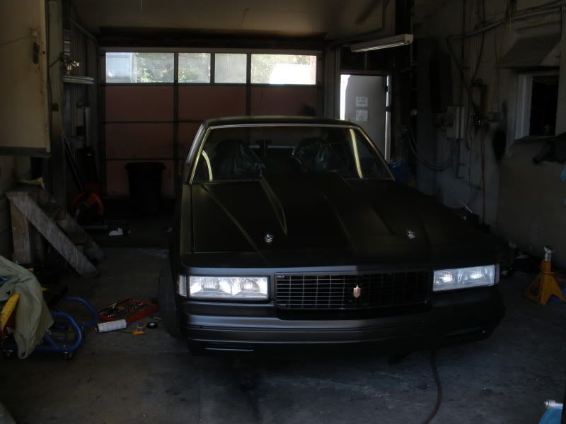

Here she is mostly put back together for those of you craving more satin in your life
Hey brotha, the car looks evil man! Did you have to put a coat of primer on first or is it a primer paint itself?

I used the john deere primer that was supplied. My base paint was in good shape as well so. Thanks guys!
