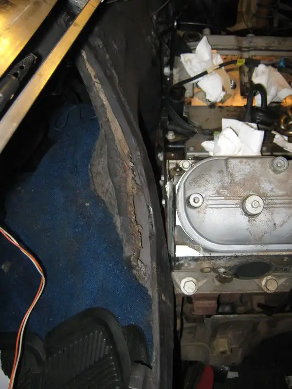

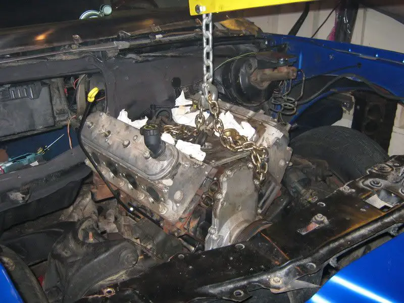

and its in, but its a rather close fit to the firewall
