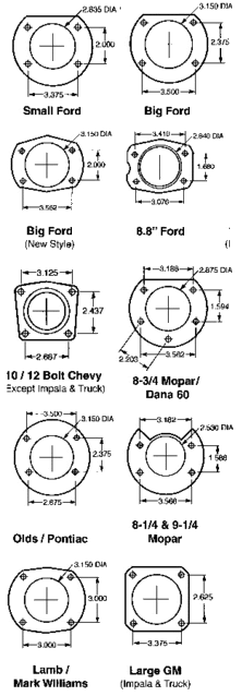

Let me first explain (this is not for a G-body). Lets say you have a rearend (8.5 10 bolt leaf spring car) that will bolt up but the axle tubes were too long (8.5" too long = 4.25" per axle tube). Can you chop the ends off, install C-clip eliminators and run stock length axles. I know there is some measuring involved but how would you go about it. Does the Ford Big End slide over the axle tube once cut ? Can someone shed some light on Ford Big Ends. What the heck is the difference between them, what does everyone mean when they say, "I would just use Ford Big Ends !" Pictures would really help. Thanks.
