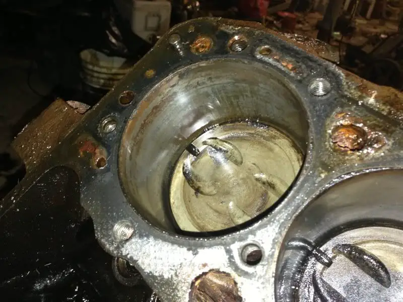

Well before getting responses I went to town on short block with engine degreaser/cleaner and also wd40. Some of the deposits of on the crank got wiped off. I also used a lot of wd40 to rinse off the the degreaser. I pulled the heads, and found some water in 1 of the cylinders, I believe it got in there while sitting since it ran fine before pulled a couple years ago. But that one cylinder looks a little iffy, it is smooth, the crude and water in there was minimal but I cleaned it off but it looks like some rust stayed behind, the cylinder feels smooth, but what do you think?
I want to try a deglazing cylinder tool that cylinder. Here's how most of the rest are:
What do you think? Can I get away with it? This motor needs to make it for about another year of use at least, while I build an lsx 5.3 for my malibu.

You are this far - I would personally re-ring it, you can get a re-ring kit from Northern Auto for about $100 which includes bearing and a gasket kit. Stick a good set of heads on what you have and the rings might not handle the extra compression. Been there and
done that.

quote: (I want to try a deglazing cylinder tool that cylinder. Here's how most of the rest are)
If you are dead set against re-ringing, use some scotch bright on that cylinder.

Spoke with my cousin that's an engine tech, and I think we are just going to clean that cylinder up good without the deglazing tool. I need this motor to last at least about a year, and we are gonna put it together with new gaskets and run it as is. I have another block that I have as backup that I rather rebuild, that one is bored .030 over already and is 4-bolt mains. I just need this motor to get the malibu running while I either rebuild that other blo or find an ls motor.
