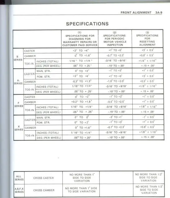

need the caster, camber, and toe settings for a 81 malibu, thanks.
6 68restomod Weekend Racer Dec 7, 2008 64 0 0 Windham, CT Jun 19, 2012 #1 need the caster, camber, and toe settings for a 81 malibu, thanks.

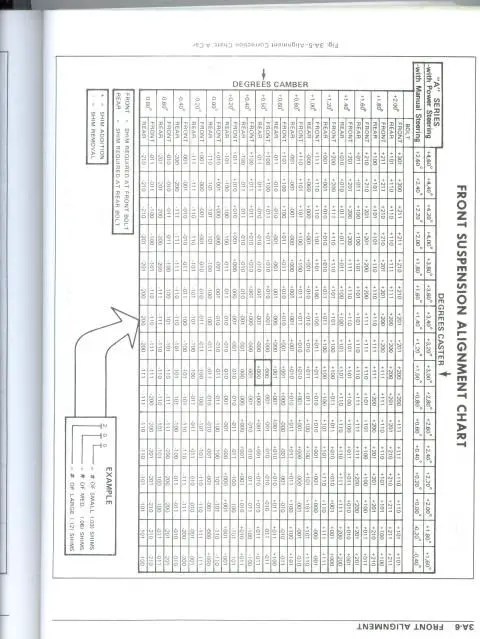

7 79Landau Frequent Racer Aug 28, 2005 372 0 0 Delhi Ontario,Canada Jun 19, 2012 #2 These are from my "70 Manual but should work for you . If you need emailed to you for quality I can do that too.
