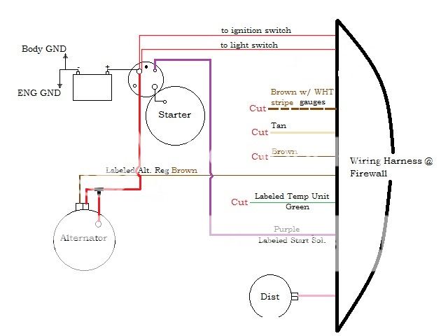

Check to see if you're getting power at the starter through the purple wire when you turn the key to the start position. If not work back to the neutral safety switch and see if you get power there when turning key to start.

This is a total noob question, but how do I properly check the purple wire with the key in start? Do I use the voltmeter (with volts selected) and check from the purple to ground or positive?

You can use a meter, or just a simple test light. One side to ground, the other to the purple wire. You don't even have to unhook the wire, just touch the end.
(it doesn't matter what side is on ground, as long as power flows through the light)

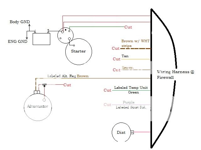

Checked with meter from bat ground to purple connection on starter solenoid and get nothing...? Checked to make sure column shifter was fully in park, tried again and still got nothing. I've been trying to look up the neutral safety switch for a 79 Malibu and keep seeing that there isn't one. On the starter system wiring diagram it just shows a note about auto trans and a "Mechanical Block" that prevents starting except in "N" or "P". So no actual switch??? Where should my next check be? The actual ignition switch? I know power is going to the switch because the turn sigs won't work unless the key is in "Run". Is that already telling me the "Start" portion of the ignition switch is bad?
The auto transmission cars don't have a NSS. There's just a jumper between the connector on the purple solenoid wire and the ignition switch. IIRC, it's up under the dash somewhere around the steering column.

Thanks Tommy! I will try to check into this when I'm off Monday, maybe my previous owner pulled a wire down there to use a push button start??
