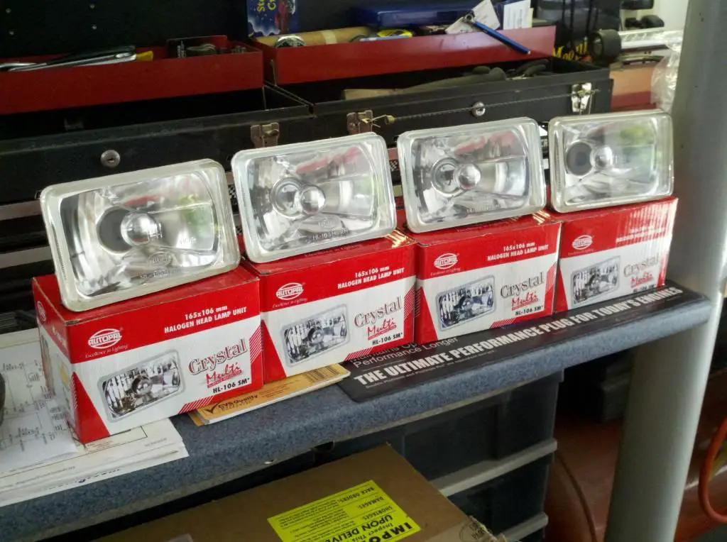

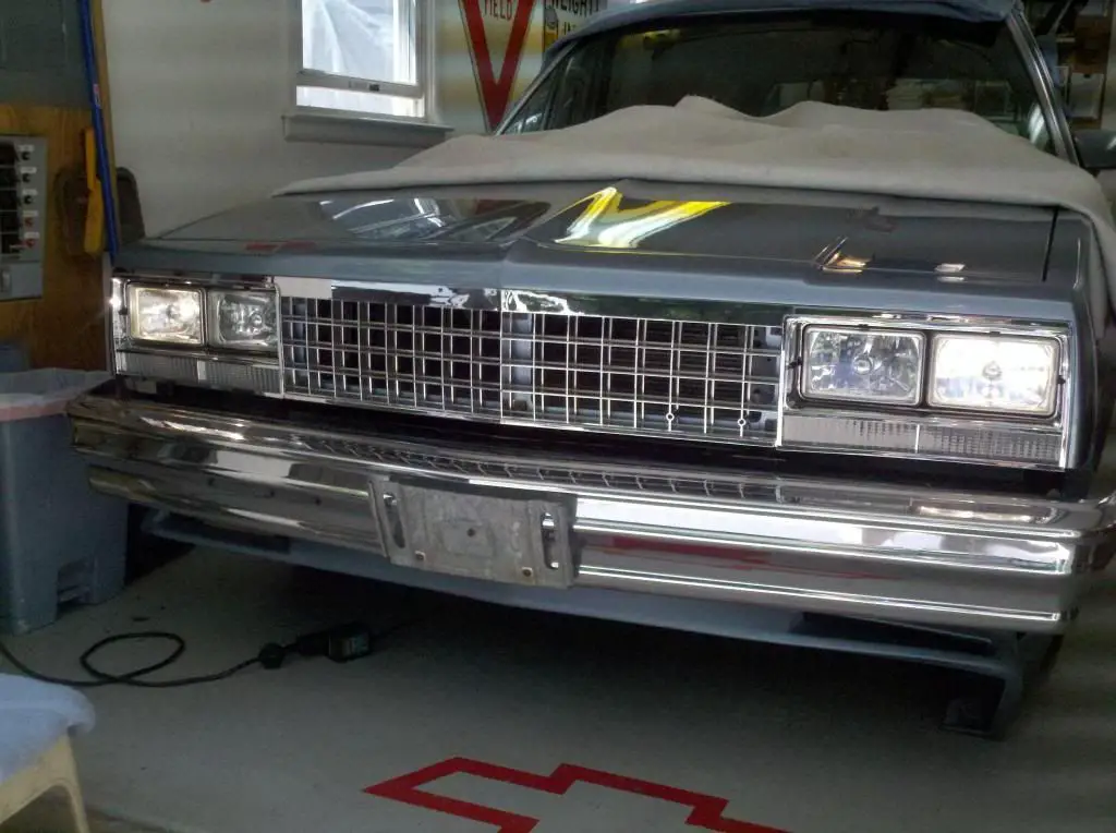

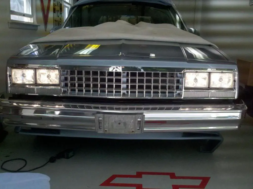

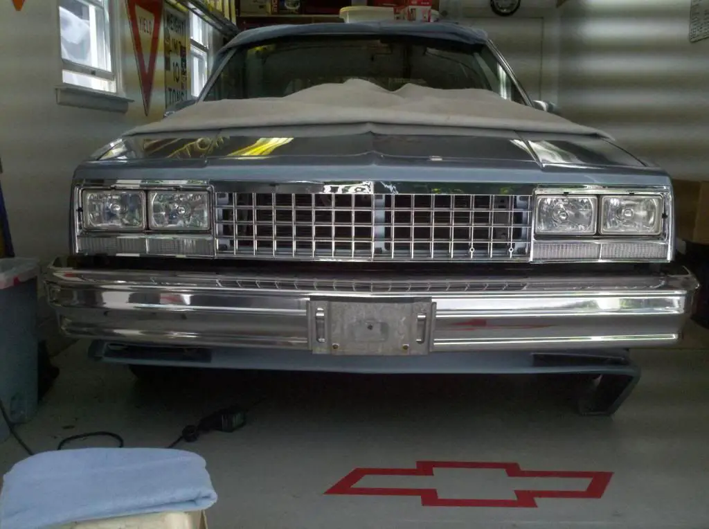

I installed the H4 Low and H1 High conversion clear diamond cut headlights this weekend and here are some pics of the end result. I haven't order the HID's yet as I wanted to get these in first. So these pics show the 4k incandescents that came with headlights. I also didn't get around to aiming the headlights. When I do, I'll post a picture of the light pattern on the garage door.
Before
After
Low Beam
High Beam

The second picture shows that all 4 headlights are on when the high beams are activated. So if you replaced the low beam with an HID kit, why wouldn't it stay on when you activated the high beam?
Wagon Master
Feb 16, 2012
125
New Jersey
Because there are two filiments in the low beam headlight, one for the low and one for the high. When you switch to high beam, the low beam filiment turns off and the high beam filiment turns on.
