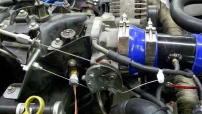

But if you want to run the manual throttle valve trans check out Bowtie Overdrives pn TVEZLS1BR. This is exactly what you need, but when you order it tell them you are running the truck manifold, the kit will come with the correct bracketry. I would recommend going with 4L60E, they are way easier to tune and that throttle valve kit is pricey. There's only so much a guy can to to get a non electronic trans dialed in.

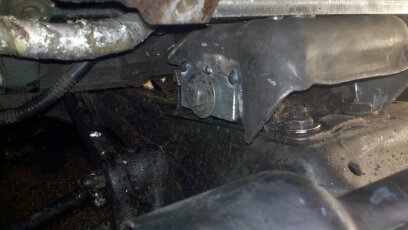

I'm using the -1 plates with modified clam shells, I cut out the hole in the clam shell that mounts to the adapter plate b/c mine didn't line up quit right. The power steering pulley did hit the gear box, I found a dorman part number for a smaller 3inch-ish pulley that worked. The smaller pulley had to be installed waaaaaay down on the shaft, I had to use button head bolts and cut a small hole in the ps/alternator bracket to tighten one of them. I got the alignment pretty close but it does squeak a little when cold but goes away when it warms up.
