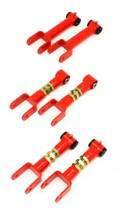

If you need some upper that will fit give us a shot. We have a poly version and a spherical version. Both versions are made from 1 5/8" dom steel with a 1 1/8" cnc machined steel and zinc plated for corrosion resistance. Here is a link to our site. Let me know if you have any questions.
http://www.bmrfabrication.com/G-Body.htm

Hello,
I wonder if maybe you got a 64-67 A-Body set of control arms? All dimensions are the same except they are longer.
Our control arms are preset to factory length and offer adjustment to make them longer and shorter.
The center to center on a G-Body upper should be 11.125"
Hope that helps!
