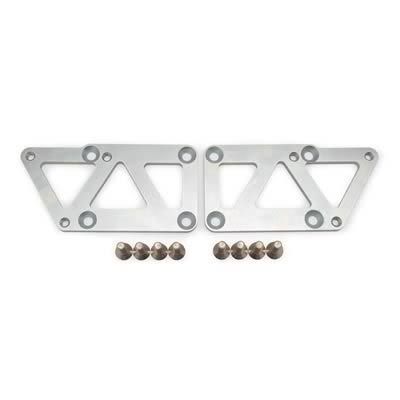

So far, I have the motor mounts figured out. I have Solid motor mounts for a first Generation Chevy engine from Moroso (Part numbers...Lower mount: 62630, Upper mount: 62515, Both Moroso). I came up with dimensions for an adaptor plate that my brother was going to make, but after research, I found that Edelbrock has exactly what i needed (Part #6701)

Edl 6701
I just got the mounts and adapter plates lined up and they are a perfect fit. Here are some pictures of test fitting everything:

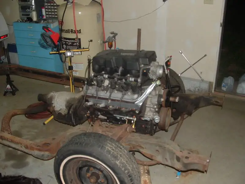

The motor

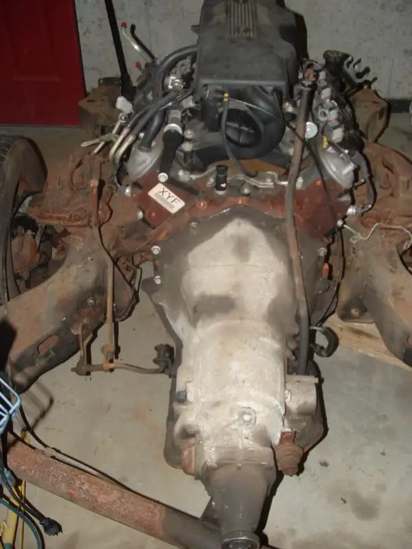

stock Trans mounted in stock location

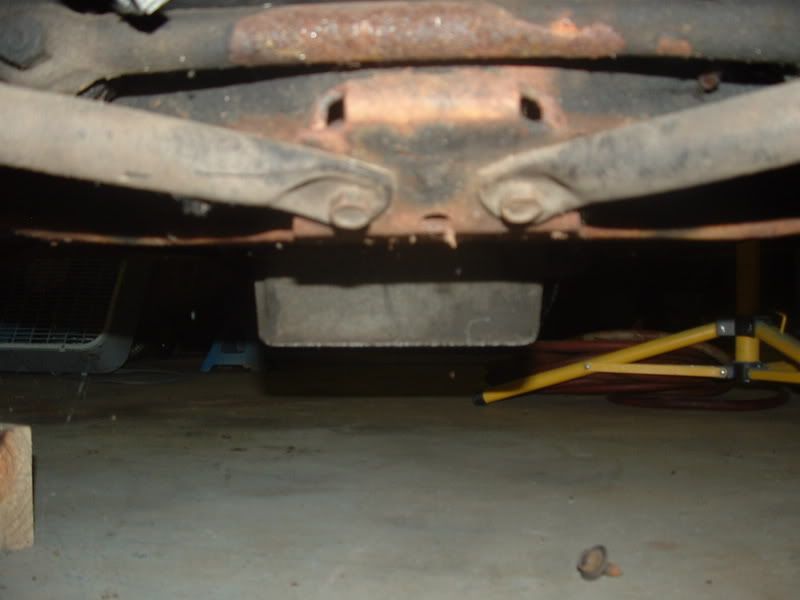

Stock truck oil pan below crossmemeber (from front)

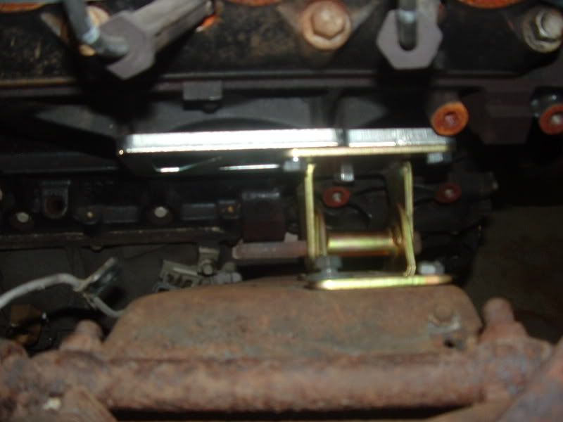

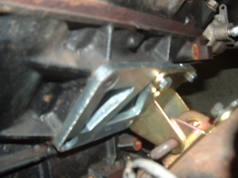

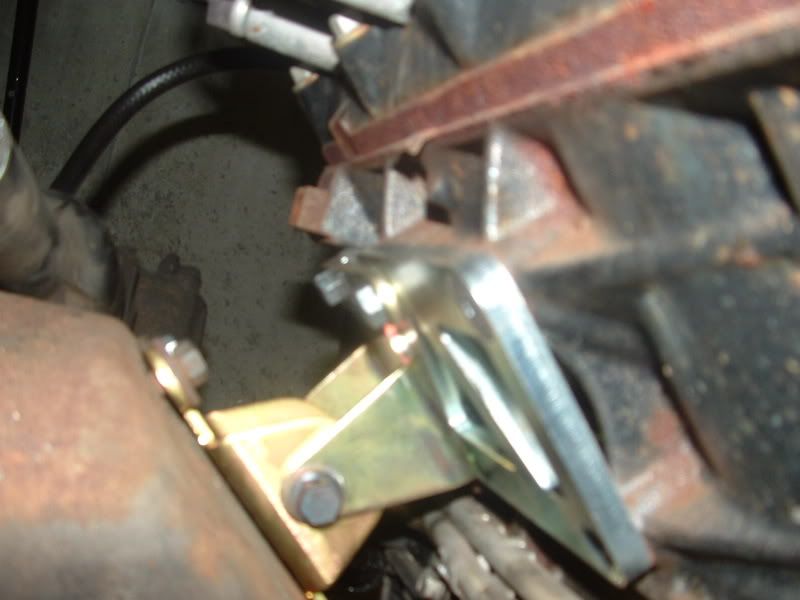

Right (PS) motor mount

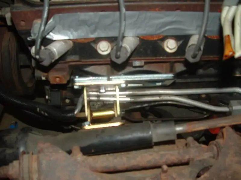

Left (DS) motor mount

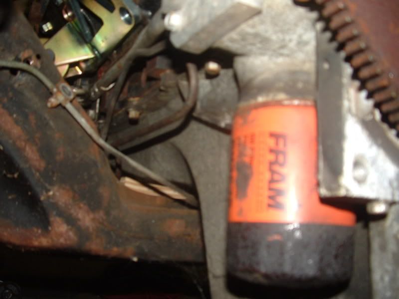

OIl pan clearance to cross member (from left side)

Edl 6701
The motor
