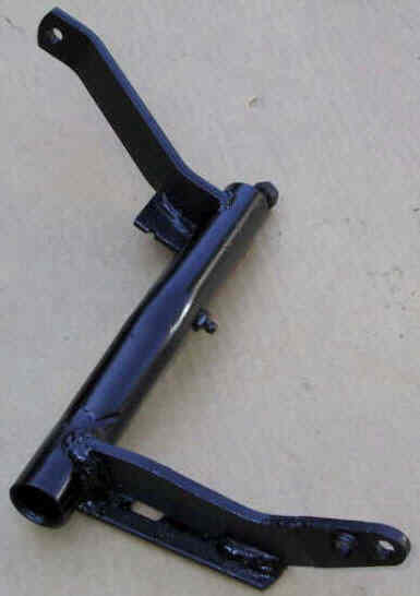

This is how the washer is added for extra support correct? Figured while I’m waiting on parts I’ll get that taken care of

The grease on your outboard ballstud looks gritty.
On the outboard ballstud, you should also have a star lock washer to keep the nut from backing off against the frame bracket. If you get the kit from OPGI, you will have one.
I hadn't seen a washer welded there before, but it can't hurt. Where did you see/hear about such a recommendation?
The failure point on these bellcranks is the lower arm peeling off. I have had a few where the weld failed and it looked like it had poor penetration.
I added braces on the tension side of each arm to prevent future failure.

I like your idea better than the washer since I had to spend a little time reaming the washer out to fit. I either found the washer idea from an old post here or gbodyforum.com I can’t remember? So I picked the wrong arm to reinforce it sounds like? Maybe I’ll look around for a little brace tonight like you used instead of a washer.

Oh yea, no star lock washer in my z bar. I didn’t even realize the back plastic ring was still inside for quite a while until I really started scrubbing the grease out getting ready to weld it.
It is good you find the plastic ring. If you bought the rebuild kit, you would have been replacing them anyway if 1 of them melted.

Ordered the rebuild kit earlier in the week. Waiting on it to arrive. I’m having a friend weld up the brackets on my bellcrank tomorrow afternoon. I have a couple welders but I didn’t want to just burn holes in it lol
