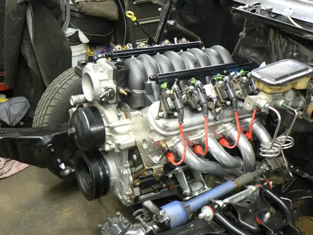

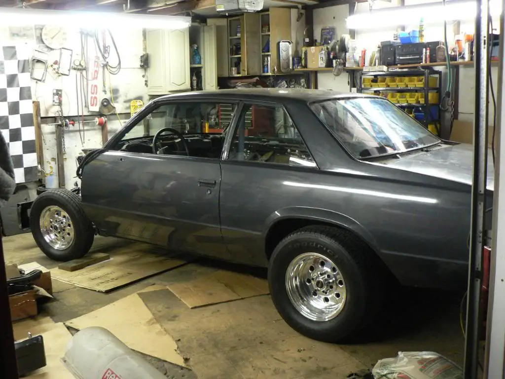

THanks for the kind words guys.
Alot of work went into this car in the last 3 weeks, from friends and family. We needed to get the suspension and driveline, all set-up so we can drop the motor and trans into the car, bolt it down and order the driveshaft.
Sandblasted complete frame, remove all old hardware and installed all new hardware.
All control arms front and rear www.spohn.net (chrome moly 4130 tubing)
All brake lines www.inlinetubing.com
LS Swap kit from BRPhotrods.com
Full built 8.5 10 bolt Grand National rearend 3.73 posi
GBodyparts --- HR anti roll bar, poly body mount kit with new bolts, and more i am sure.
RAlph

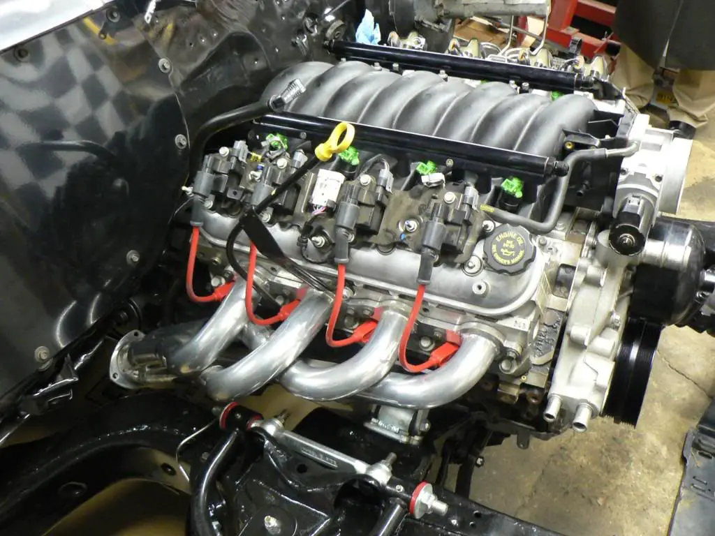

Re: NEW Project 1978 Malibu LQ9/4L65 Swap(MORE PICS)
Stock Brakes and spindles for right now.
Since the calipers were like 10 bucks each, couldn't pass it up. even the rotors were cheap too.
Here some new pics

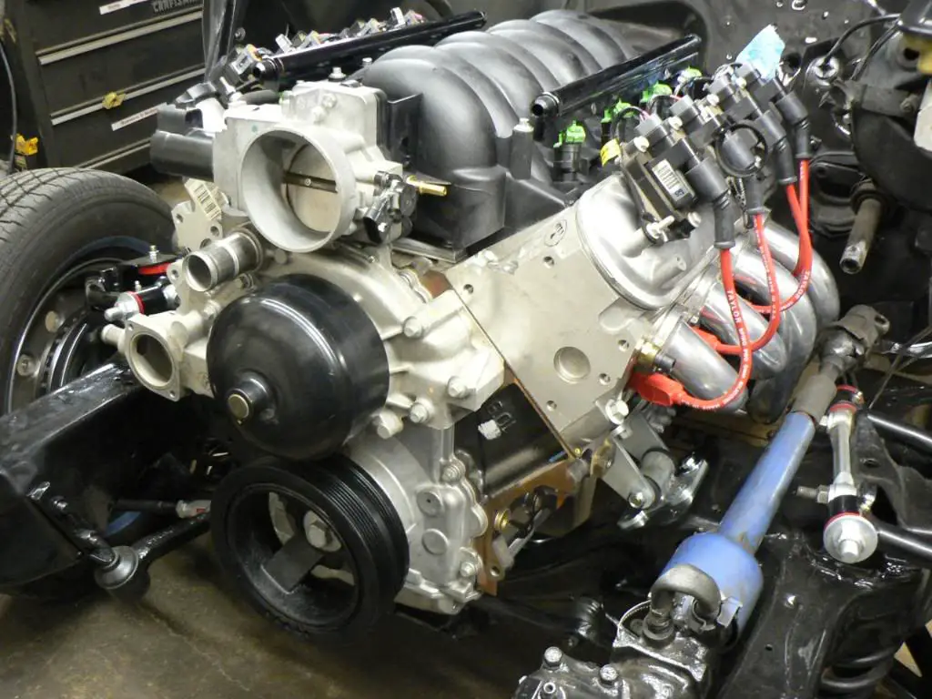

How do you block off the tubes coming out of the water pump that are soposed to run to the heater core? Since you got rid of your heat do you just run them into each other or put caps on them?
BoostedbuLQ9
Dec 16, 2008
243
Ocean County, NJ
Either rubber caps or you pull out the nipples and tap the holes for AN fittings and cap the fittings.
