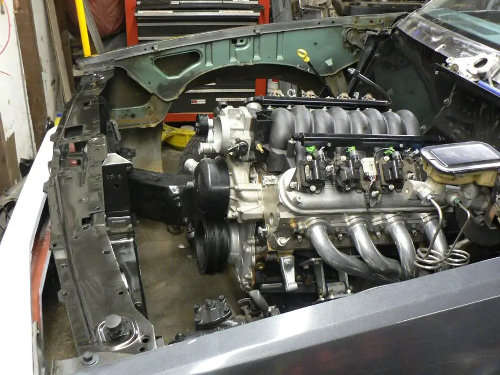

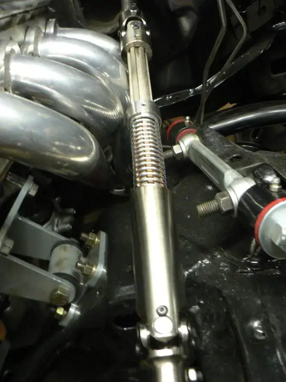

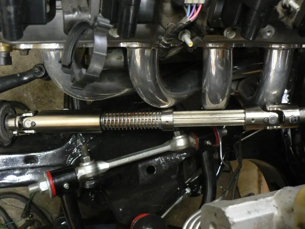

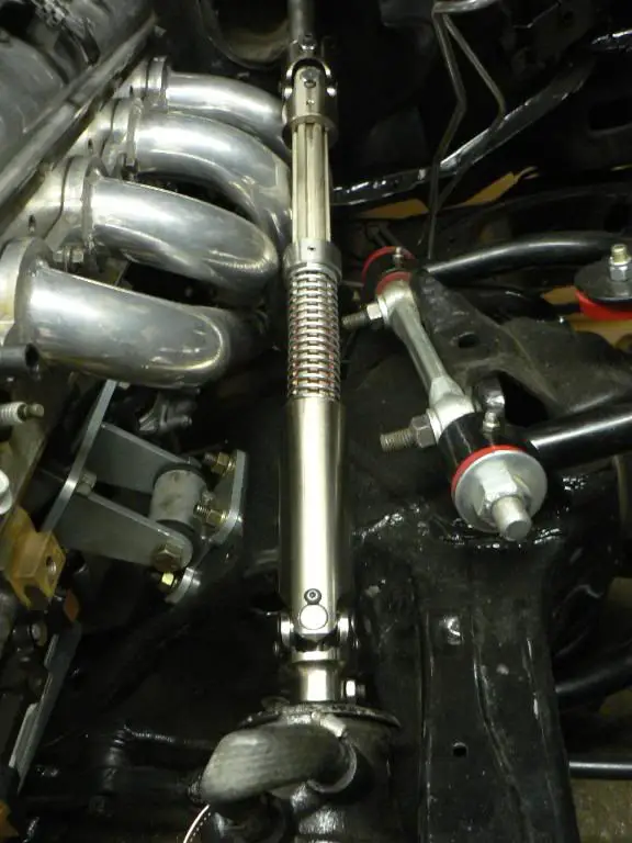

With those headers, mounts and the new steering shaft what is the header/steering shaft clearances? Looks great, but looks tight.

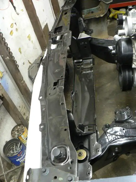

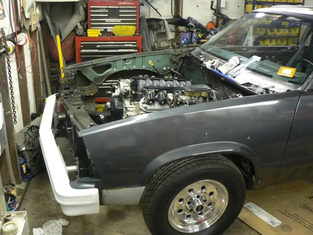

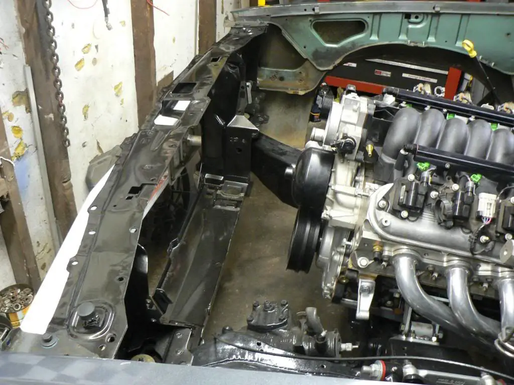

Looks like he's got the normal g-body floor rust problem, like I do :cry: The screws are holding the floor patch panel in place.

Re: NEW Project 1978 Malibu LQ9/4L65 Swap(MORE PICS)
Quick question on the flaming river shaft, which one is it, and how long? I bought the jeep one, but that one looks a million times better. Do you have PN or anything?
Thanks
Otis
BoostedbuLQ9
Dec 16, 2008
243
Ocean County, NJ
Thanks
Otis
Now I bought from JD's Performance out of FL
I have 88 Monte Steering Shaft so it has 1"DD Shaft
Part # FR1857-20 EZ Shaft
1DD Upper Spline and 3/4-30 Lower Spline
It was about 250 bucks to my doors.
RAlph
