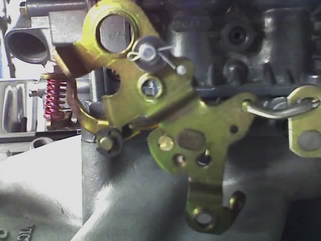

Might be.
Another common screw-up with a Holley is to put the throttle cable stud in the wrong hole. It goes here:
Everyone wants to put it in the bigger hole just below that, but that's not where it belongs. As you can see, that lower hole has a lot less leverage on the throttle arm than the proper hole.
