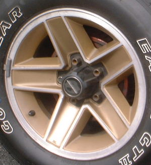

I recently changed front suspension setup to stock height coil springs (Moog 5600) with Belltech 2" drop spindles. I'm currently running 15x7 MCSS wheels with 3.75" BS and a 215/7/15 tire. The tire is rubbing close to the outside edge of the wheelwell. The tire is too tall and seems like I need more backspacing. So, I'm considering purchasing 17x8" wheels with 4.5" backspacing. Will these wheels have any interference issues with the tie rod? Anybody else running something similar that can tell me if I will have rubbing issues (245/45/17 tire, 17x8" wheel with 4.5" BS, 2" drop spindles)?
The 17" tire/wheel combo will have more backspacing and the tire will be almost 1" smaller in overall diameter, which I hope will center the tire better in the wheelwell and not rub, especially with the smaller overall diameter tire. I'm mainly concerned about rubbing the inner side of the wheelwell and tie rod clearance.
