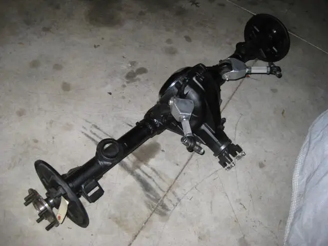

I sell the upper controls arms for the center section conversion. We build housing and axle package for your g-body 450.00 gets you a housing and axles. The upper control arms are 140.00 a set. MOSER ENGINEERING AXLES. You will be able to use all your stock G-body brakes and will be stock width drum to drum and if you need to you can use stock GN axle in the housing...
