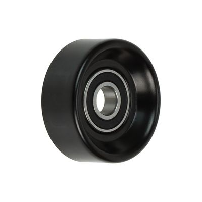

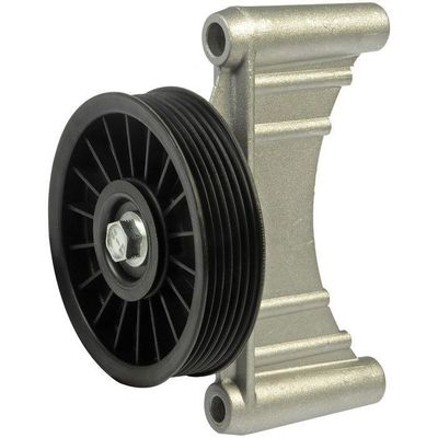

I'm looking to do the serp. Swap but I would rather keep my manual steering, is there an easy way or bolt in idler I can get to eliminate the power steering pump?
