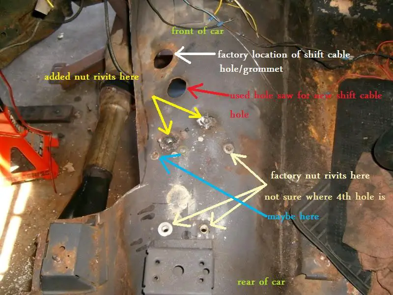

I used nut rivits (similar to the factory style set up to install my shifter) they are threaded inserts that rivit in

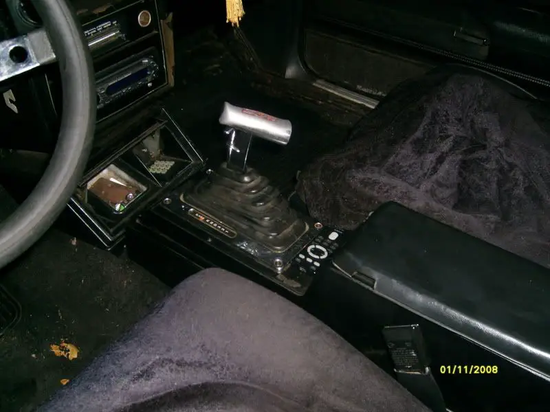

I eyeballed it where it should sit, installed the nut rivits where the ears of the shifter sat, and cut the top plate of the center console to allow the shifter to pass through, then attached the upper chrome trim plate of the shifter to the center console top plate. I believe I used the factory rear nut rivits (but can't remember 100% its been a while and burnt those brain cells lol) and installed two new ones where the megashifter mounting points sat as it was different than my factory floor shifter.

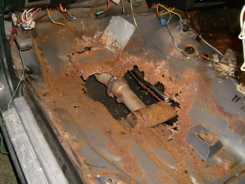

this is when i was replacing the floors/doing t56 trans swap hard to see but you might get the idea
here you can see I used 2 nut rivits in the rear to hold it in place
this is with it installed prior to floor replacement/trans swap
here is a view of the nut rivits (again i cant remember 100% if I used rear factory nut rivits, or the two holes in the plate or not but I am assuming so, my car was an original factory floor shift car) I remember because of the rust (my car was a daily driver for at least 4 years and saw plenty of Chicago snow and salt) the nut rivits had pulled through after a few years and I had to re-weld them in. cant tell where exactly the 4th hole is (or if there was one) but this diagram I made on paint should help!
