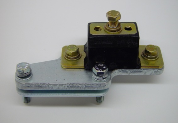

Just need to change the Trans Mount.
The 3.8 did use an Offset Mount.

That would make perfect sense! I do plan to run duals on this so I think Im just going to go the route of a new xmember!
Thank you all for you help here!
