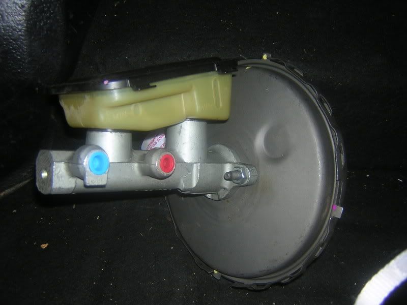

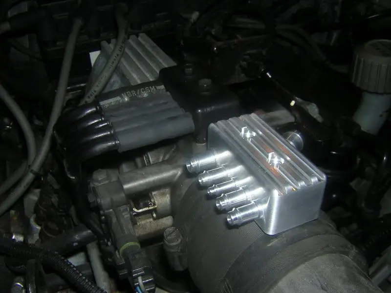

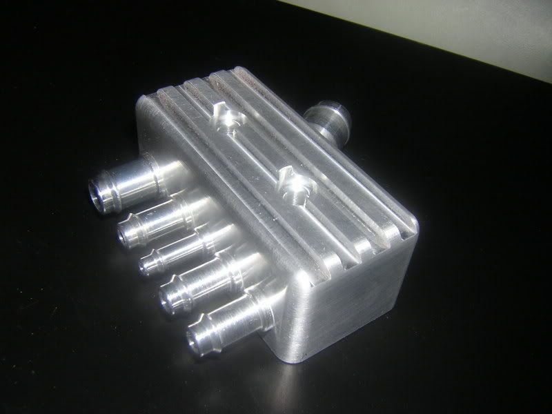

The powermaster is starting to go down hill on the T-Type. Instead of replacing the accumulator ball or getting a re-build kit for the master cylinder we decided to go with vacum brakes. Got the new vacum block with the extra nossle for the vacum hose.

nice lookin setup!
Umm, T-types & GN's ran the Powermaster system for a reason-I don't think you'll build enough vacuum to run the brakes really well. They'll probably work, but have bleed down issues.
