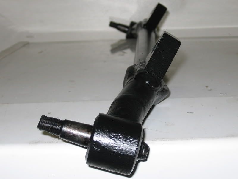

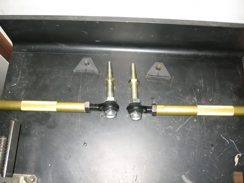

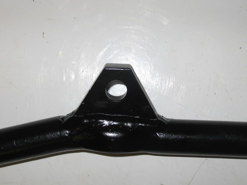

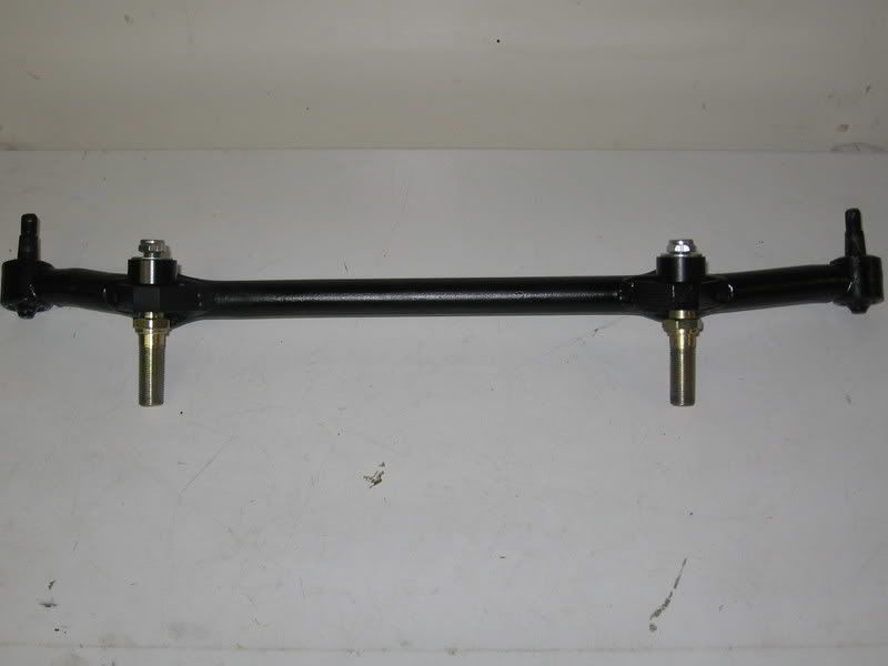

Unfortunately,Those adjustable centerlinks do not have enough adjustment to eliminate the bumpsteer issues with b-body spindles. They only give you .25" of height adjustment whereas you need around .625". I made my own adjustable centerlink to fix this. see pics below
Any thoughts of selling those? I don't have much in terms of fabrication skills, but I'd love to be able to tune out some of the inevitable bumpsteer associated with the B-body spindles used with my GW suspension stuff.
