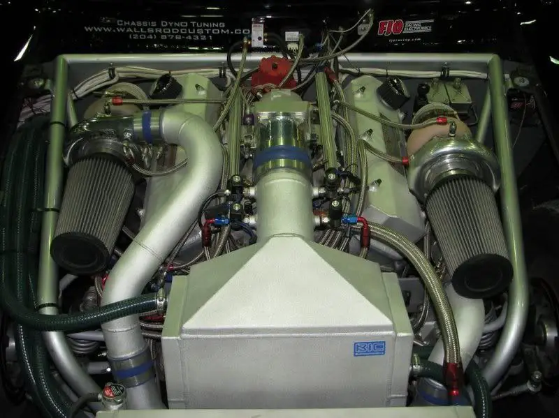

the nelson racing engines kit is just on the high end of the scale... about 5000 for the manifolds.. 8500 with turbos, WG etc.. and somthing like 16000 for everything including electromotive tec3 and so on...
585ci Schmidt motor with twin T80s
